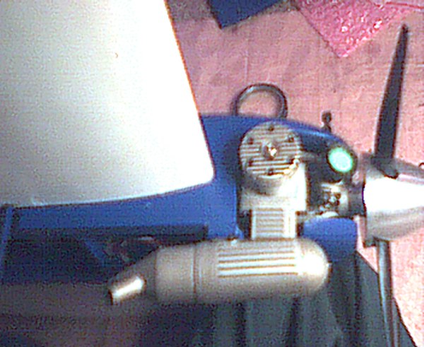

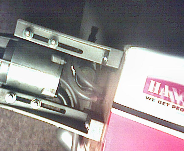

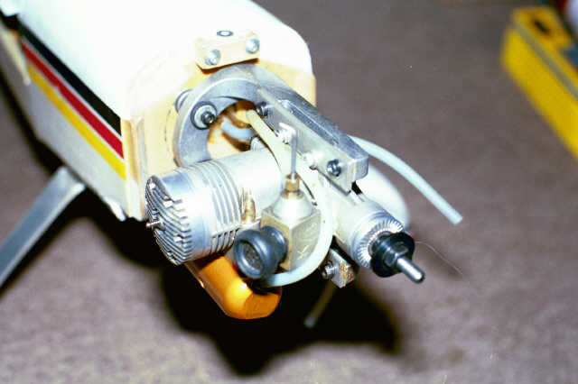

Two ways to control the splatter out the intake. One is an air filter, such as the BruLine from Tower Hobbies, the other is the inlet stack.
First picture is my Magnum 25 with a stack that I put on it as an experiment. I didn't notice any power increase, but the plane stays a lot cleaner with the out spray controlled, and the fuel economy seems to have gone way up. And it may be subjective, but it seems easier to tune also.
Second and thirs pictures are a Saito FA-120 with both the stack and the BruLine filter. The combination made a very nice engine even sweeter.

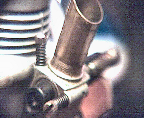

More. I also have the BruLine filters on Magnum and K&B, with the same increase in fuel economy.
Coouple more pictures. First is a K&B 61 in my Diablo, second is a Magnum, the right engine in my C-3/10.
