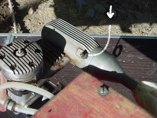

The fitting are about 3 bucks. There should be a fat area to drill and tap.
Here is where it is on a K&B .61.
You should have a pressure fitting for the tank.....without it your engine
will lean out while accelerating, or in climbs and could overheat . []
FBD.

A closer inspection and disassembly of the muffler finds bad news. The wall of the muffler is approximately .30 thick and it is uniform throughout - - no thick area for potential drilling and tapping. I have sent a message to K & B to see how they can help. I don't believe there is enough "meat" on the wall of the muffler to allow a tap to work but I'll see what K & B has to say. Thanks so much for your time and efforts to help me. It is obvious that this forum is filled with people of great knowledge a desire to assist other R/C folks.

Drill a hole for the fitting and put a nut on the inside of the muffler for the fitting to screw into.

You can always drill and tap the muffler extension that bolts to the engine. That should be thick enough for a tap.

Or just buy Du-Bro's number 241 6-32 pressure fitting. It comes with a nut to go on the inside end. $1.45 MSRP.
