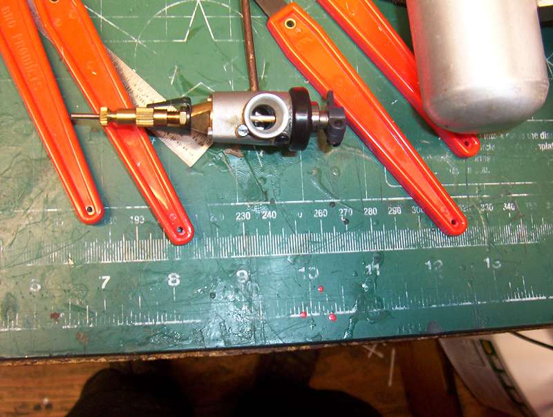

Default RE: G75-G90 differences?
ST has two styles of spray bars, round ones and ones with both sides ground flat to increase the venturi flow area. I have a lot of ST carbs, I use them on other brands that have iffy stock carbs because the ST carbs are infinitely tuneable.

Hobbsy's Avatar
My Feedback: (102)
Posts: 20,370
Received 30 Likes on 28 Posts
From: Colonial Beach, VA
Spraybars
ID:	156147   Click image for larger version
