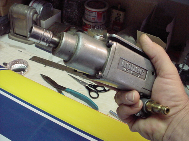

Help,
I am trying to remove the prop from a saito 100 mounted on a H9 P-51. The problem is I can't turn the prop nut (spinner adapter) without turning over the engine. Holding the prop no longer helps as the prop is now loose enough that the shaft rotates inside the prop. With the cowl in the way, albeit loosened, I can neither get the glow plug out to jam the piston with a dowel. nor can I get close enough to the prop flange to hold it from turning when I attempt to turn the prop nut. I don't have much hair left as it is, but I am ready to pull what's left out!!! Do I have any recourse other than cutting the cowl off......I REALLY don't want to have to do that! I am open to any and all suggestions/advice on this little quandry I have gotten myself into. Thanks in advance.

Old 09-26-2004 | 10:48 PM
Flyboy Dave's Avatar
My Feedback: (21)
Posts: 13,864
Received 10 Likes on 10 Posts
From: Pinon Hills, CA
Default RE: Prop Removal AAAARRRGGGHHHHH
Take the engine down to a local shop, and have a mechanic hit it with a 3/8
"butterfly" air impact wrench....and a 6 point socket. [sm=thumbup.gif]
....the nut will be loose in .0012376 seconds....
FBD.

Old 09-27-2004 | 07:01 AM
Posts: 20,205
Received 20 Likes on 15 Posts
From: Mary Esther, Florida, FL
Ken:
The air wrench idea of Dave's is probably the easiest, but if you can get to the engine air intake you can fill the cylinder with oil, a deliberate hydro lock. You can then clear it by turning the engine backwards.

Old 09-27-2004 | 12:47 PM
Joined: Jun 2002
Posts: 36
From: union, KY
Dave,
The pneumatic wrench sounds like a good idea. I have one, never thought of using it. I'll need to find a deep socket to get past the spinner adapter and on to the nut. Thanks for the suggestion I will give it a spin...so to speak!
Ken

Old 09-27-2004 | 05:37 PM
Joined: Jun 2002
Posts: 36
From: union, KY
SUCCESS!!! Thanks for all the input. After thinking about the impact wrench suggestion I thought I would try one thing before I used pneumatics. I took my 18volt cordless drill and just tightened the chuck down on the spinner adapter much like you would do with a drill bit in the chuck. I then hung on to the prop and let rip with the drill. Worked like a champ! That drill had ample torque to break the nut free and the chuck had no problem hanging on to the spinner adaptor/prop nut. Needless to say I am very happy. Again thanks to all for the suggestions, it really got my mind going in the right direction.
