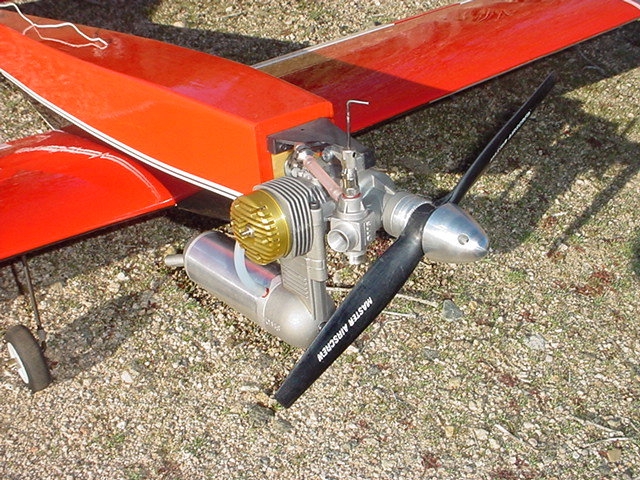

Maiden test flight to day all went WELL .... the GMS .47 ( in the blue Cutlass) with the mods to the carb PLUS the spray bar / needle valve miked to .002 WORKS fantastic ...used a Hanger 9 super plug to keep the fire going ...all i can say is what a fine and very smooth engine.

I fixed a brand-new, fresh out of the box GMS47 the other day by doing this:
1. shortened the spraybar by about 0.5mm.
2. drilled the brass insert to overcome the mis-alignment problem.
3. added teflon tape to the remote needle-valve so as to kill the air-leaks.
Now it runs just fine.

Hi Wayne; I have only dealt with the spray bar to solve this issue. (Anyone interested as to why see post #352 - Please note engine was tuned for best idle and transition first).
I first started by only taking off as much as the bevel at the end of the spray bar. This only changed the # of turns out for the idle setting (best idle and transition ) but did not solve the problem. I decided to take more off. The second time was a charm. After tuning for best idle and transition, WOT finally belonged to the high speed needle valve. The low speed needle now clears the spray bar enough to slide a piece of heavy weight paper in between. The spray bar now protrudes only 1/8". (Sorry, I don't have a mic and there was no disassembly involved as I only backed the low speed needle out of the way - but here's a pic). Cheers.

Some one in a early post had miked it out to .002 to .004 ... I tried this and it worked ..and this was with out filing the low speed needle or bar.

After ... you can see the spray bar is shorter. You can see the gap if you zoom in ... it's just enough to slide a piece of paper in.
