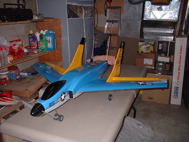

Well it may not be a Extreme speed plane like the SU27 but it does have a U in the letter F7U3 and the colors look familiar. This is my almost finished Cutlass45 that I have been building and have installed my reworked new GMS .47 ...here is the tread on it.
http://www.rcuniverse.com/forum/m_31...tm.htm#3192753
cheers
cheers
