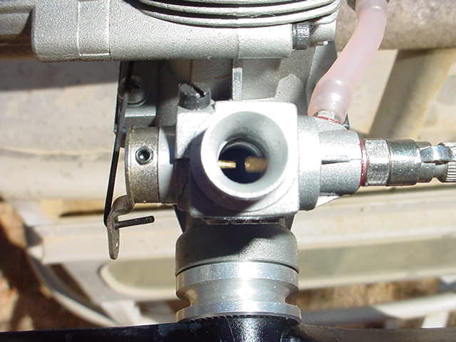

#432
My Feedback: (21)
ORIGINAL: JDW
Flyboy Dave
It's simply not worth discussing this with you - you simply don't read what is written and you obviously have no idea at all about fluid flows and pressure effects with accelerated flows. As I said before - try it - you might like it!
Xjet is on to it - I guess you'll bag him as well!
In the meantime I'll wait until someone else has something intelligent to say on the subject.
Flyboy Dave
as well check out your Magical carburetor geometry and tuning theory.
I must admit, I am a little Old Fashioned and set in my ways. I thought I might
even learn something new. I have real bad news....your theory was just that, a
theory.
It didn't pan out. In fact, everything you stated in your theory proved to be wrong.
At least I gave it a shot. I took my GMS .47 out today and did the idle screw
test. You said the idle screw had everything to do with the high speed mixture.
I said it had nothing to do with the high speed mixture in the WOT position.
Your position was that the leaner you set the low speed, the better the engine
would run....due to a bunch a magical theories that you alone know about. You
claim that leaning out the low end not only cures all the ills of the problematic
GMS .47, but is the sole source of the fix....and all the other problems
are not in themslves problematic....rather, a waste oF time.
Your magic tuning theory will overcome all these slight problems !
Well here we go....

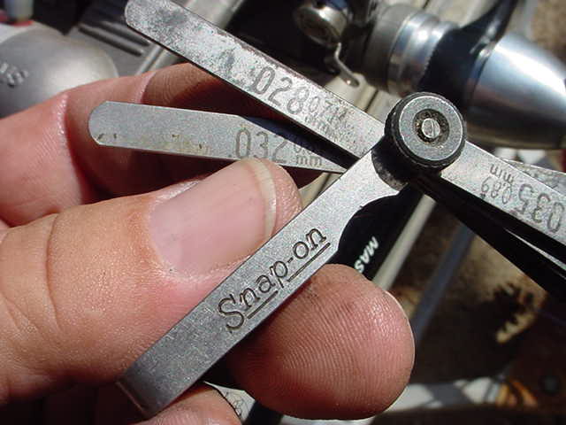

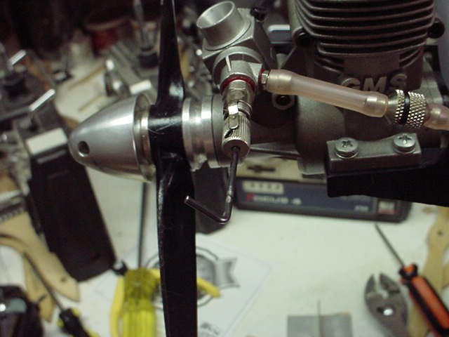

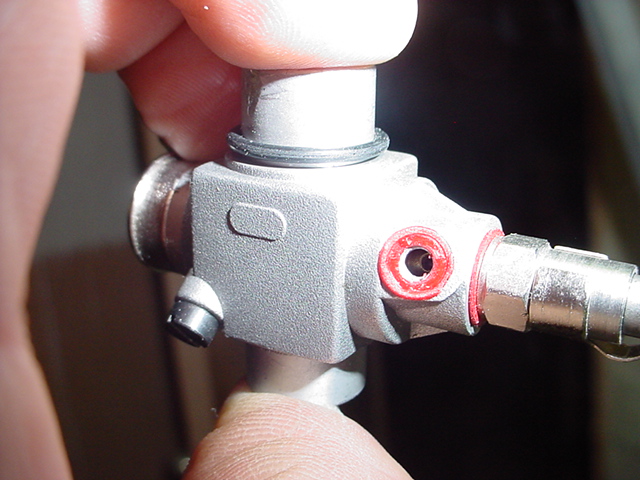

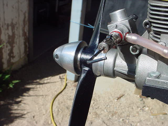

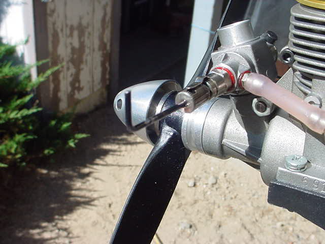

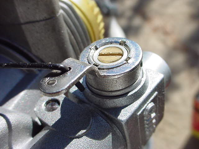

1. shows the position of my idle screw, after I had done all the mods, and had
the engine running perfectly....with about .008 distance from the spray bar. It
looks more like .010, but I eyeballed it at .008, so let's leave it a that.
2. shows the actual gap. For those keeping score at home, a matchbook
cover is .013".
I started the engine, and let it warm up for a minute....then I shut it off and
opened the low speed needle 1/2 of a turn. I restarted the engine with an
electric starter each time. I figured that as I enrichened the low end....
moving the low speed needle away from the nozzle would kill any chance
of an idle. I was right.
I opened the low speed needle 4 times....1/2 turn at a time, two full turns out.
Pic 3 shows where the screw ended up. See how much further out it was
when I started, and trust me....it was set perfectly.
Now for the fun part ! See the gap in Picture 4 ? A whopping .060
.Guess what happened to the high speed ?
Nothing. The high speed rpm stayed at about 15,500 or so at every stage.
PIc #5 shows the combination of feeler guages that were needed to measure
the gap inside the small carb.....060"....
....acording to your theory, this is impossible. Acording to my theory, in which
"once the low speed needle clears the nozzle, it has no effect on the high speed
setting....in any way, shape, or form".
This turned out to be true, just as I expected....sorry. [
] The engine ran the same on the high end, fron .008" gap to .060" gap....just like I said it would.
PIc #6 shows how I left the main needle the last time I ran it. Trust me on this,
it is a richened position....I don't shut my engines off at a full peak setting. Let's
call this a 10:30 setting, shall we ? This measured two turns, plus two clicks.
Pic #7 shows the position of the main needle at full peak with the gap at .060".
Guess what ? It is set at 1/4 turn leaner than the .008" setting !!
As any tuner knows....when you enrichen the low end (opening the gap) you
will probably have to lean out the high speed.
Pic #8 shows the way I left the needle...richened, like I did before. The setting is
1 and 7/8 turns out....with the .060" gap.
This setting is 1/8 of a turn away from the initial setting (richened) of two
turns, plus two cliclks.
Sorry, my friend.
FBD.
#433
ORIGINAL: JDW
Wrong Flyboy Dave!
The MOST critical aspect of these carbs is the position of the LOW SPEED NEEDLE relative to the end of the spray bar tube (or nozzle)at FULL THROTTLE.
It is NOT a large gap as you suggest but is about .002in and is very critical. It is NOT critical because it changes the low speed mixture, but because it changes the venturi effect and therefore the fuel draw at full throttle.
Wrong Flyboy Dave!
does have an influence on the high speed, but only to a certain point. This
will vary on different carbs. The gap is really quite meaningless. The way
the carb operates is the important thing.
MB.

Hey I need some guidance, I have a GMS .47 ABC. The motor has about four or five tanks of fuel run through it. It idles perfect with the low speed slightly off of rich. It will transition from low to high with no stuttering. The only problem is when I hold the plane straight up the engine slowly begins to lose RPM's and finally dies off. I have checke the fuel lines, replaced the glow plug and pulled the tank and replace the fuel line and tightened the plug on the front of the tank with no luck. Am I looking in the right place with the fuel tank or could my problem be elswhere. The plane is a Hangar 9 Twist and the tank is installed with 1/2 inch foam arond the tank. (foaming in tank???)
Chuck
Chuck
#445
My Feedback: (21)
Remove the fuel inlet nipple from the carb. Check the hole where
the fuel passes into the needle assembly and see if your's is
mis-alighned like mine was. Also check to make sure the nipple on the
muffler that pressurizes the fuel tank is drilled correctly, and also look
at the nipple you removed on the carb inlet for a nice clean inlet hole.
You are not getting enough fuel into the carb, and it is leaning out. This
is not good, because it causes overheating, and could damage the engine. [
It is easy to fix.

Well I believe it may have been the fuel tank. I swapped tanks and so far it seems to run like a champ. I shall see once it's in the air. I did check the fuel inlet nipple and it was about a 1/4 blocked so I drilled it just to eliminate that problem . Thanks for the help.
chuck

See my post on page 13 0f this topic. Your problem is EXACTLY what I experienced. I found a fix which worked on my own .47 and which I have now also used to cure other misbehaving .47s. It's worth trying this before you start any drilling of holes etc.

Thanks to Dave, I found my fuel inlet was not sufficiently sized and mis aligned. I got the motor started immediately after it was bored out. I am still confused on the proper needle settings however.
dickj
