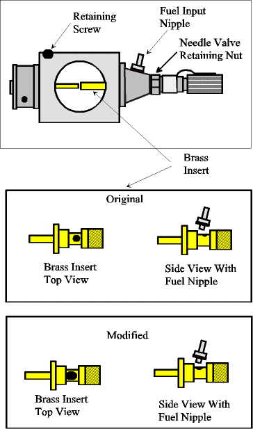

Hey Guy's!
I hadn't heard anything from this thread or any others on RC Universe in a long time. I decided to check and make sure there weren't any other remarks on any other forums about the GMS .47. Imagine my surprise, when I found that discussions were still going on in this thread and I wasn't getting notification. I hope RC Universe didn't black ball me or something
I ordered my replacement carb body from Tower, and received it a few weeks ago. The new body had the hole in the spray bar in the same place as my first spray bar. It is slightly off center, but none of the holes on either spray bar is hidden by the wall edge, as was the one in my friends bad runner. I have not run mine since putting all my old carb pieces on the new body, as I have retired my SE and ordered a 4D. I hope to get everything going in the next 3 or 4 weeks.
Wayne, by the way, thanks for giving me credit for solving the turbulance issue. I am eager to hear others that try replacing the carb body. I don't believe the hole has to be dead center, but you should definately be able to see the entire hole when you remove the nipple from the carb body.
Talk to you later!
Andy

Hi Flyer Freq,
Funny you just posted, I saw Spicoli's name in another thread and just PM'd him to ask how he made out.
Since my last post I've modified 3 GMS .47's by just drilling out the intake nipple and making the hole in the brass insert as large as possible directly under the intake nipple - as shown in the previous pictures.

Just another datapoint, after getting our club's GMS47 engines running okay with different mufflers, I went back to the original GMS mufflers and added a stainless steel restrictor/extension to the tailpipe, which is also a little longer than the original. I also welded the two muffler halves together (they never seal properly otherwise and we've had at least one through-bolt break so welding them solves both problems).
The pressure nipple was also replaced with one that allowed a 0.5mm larger hole.
I also ended up making inserts for the mounting threads because the original screws stripped out on two of the mufflers. I made the thread-inserts of brass with an M5 outside thread and M3 inside.
Now the engines run great, the planes don't get covered in black gunge from the two muffler-halves vibrating against each other, and you can torque down the mounting bolts without fear of stripping.
One of our guys is now actually able to use his GMS47 on a 3D ship and since we modified and re-fitted the original muffler, he's never had a single dead-stick and the engine runs/transitions perfectly despite all those G's and wild throttle control inputs.
So we've got them running great -- but is it worth it?

Hey Wayne!
Curious to see the overall feedback from elongating that hole. It resembles the rectangular cut made in the spray bar of some of the Super Tiger engines that had midrange issues. ST went back to a round hole now, from what I have heard. I don't think the shape of the hole is as important as where, on the needle, it falls. This may be a good fix. I can't wait to get back to flying again!

XJET:
I have looked at a few of the latest engines from GMS. It looks to me like they have corrected the hole alignment problem. While the hole is not dead center, it is not so far out that the fuel has to make a 90 degree turn to get through it. I am back to recommending the GMS again. With the problem solved, they make a great 3D engine.
Just a word of caution on the TT engines. There are some quality control issues and poor customer service issues with ACE RC. I hope I can say that without getting slapped. Our local hobby shop discontinued the entire TT line, because they couldn't deal with ACE anymore. You can read on many threads within RCU to back this up. I have always liked the TT line also, but they have their issues, just like everyone else, I guess[

Joined: Sep 2003
Posts: 1,286
From: DrumboOntario, CANADA
Hi Flyer Freq,
Thanks for the information on the hole alignment on the new engines. It looks like they are agreeing with the fix.
Although I doubt if it will ever be acknowledged, I bet we had a lot to do with getting the problem fixed.
