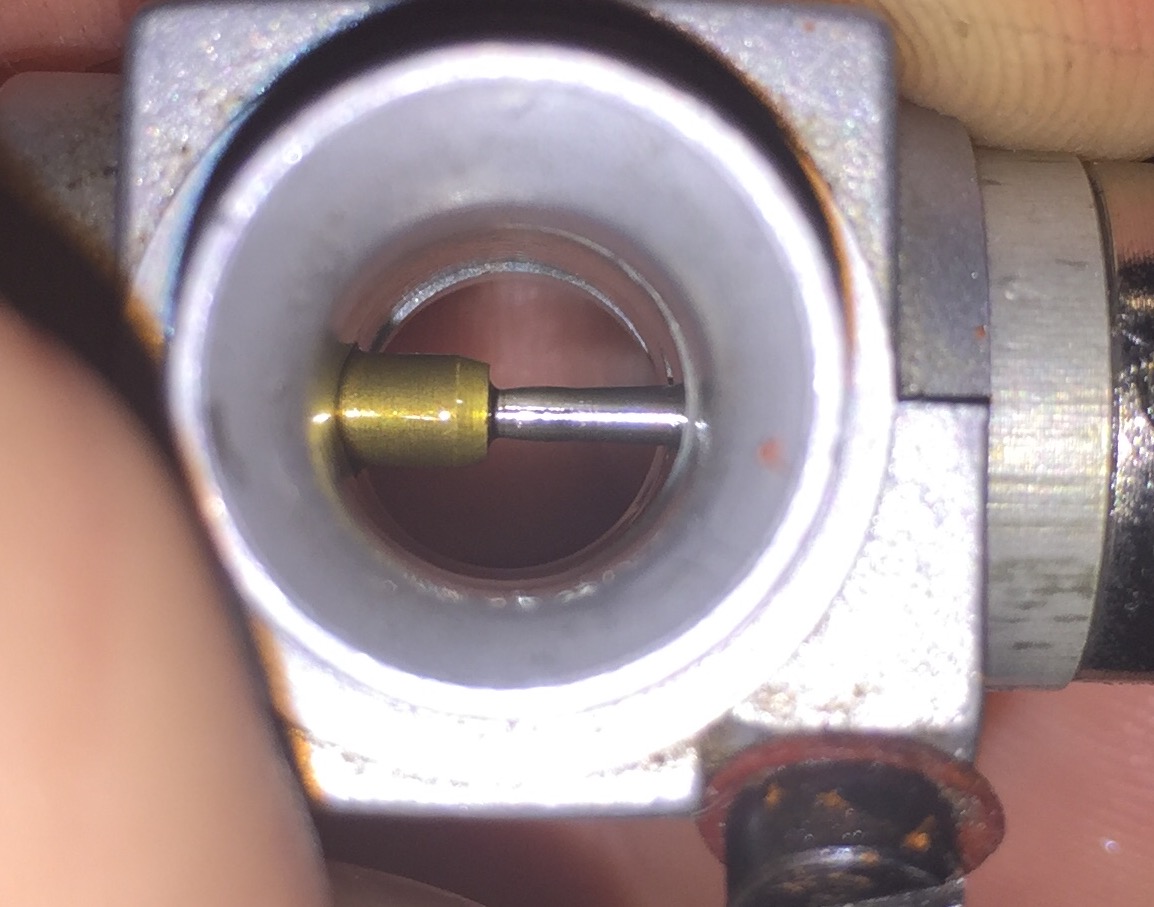

I am necrobumping this thread up due to a question. Hopefully some of the fellas that contributed to this thread are still around.
I recently acquired a near-new GMS .47 engine (non remote needle version) that I'm trying to get running good. I've read the whole thread with great interest and have a question in regard to the idle needle/spraybar interference issue. I already fixed the fuel inlet misalignment problem, but now I need to deal with the idle needle and spraybar interference problem. As has been noted, if the idle needle is set for good idle and transition, the high speed operation runs lean and no amount of needle adjustment on the high end will richen it up enough without having the idle needle set way too rich. Is it better to shorten the spraybar or the idle mixture needle and how much needs to be taken off to obtain good results? FWIW, I ran the engine with an Irvine carb and got good idle and transition, but the smaller throat carb robbed a lot of power from the engine - at least 2,000rpm. So I'm very motivated to fix the GMS carb. I do not have the GMS/Tower muffler, but I do have a red Jettstream muffler.
Thanks in advance.

I would advise you to FIRST verify the issue is that the engine is not getting enough fuel at high speed with the LS needle set properly.
Scribe or record your exact LS needle settings that you are using now.
Then richen the LS a bit and start the engine. Tune it for best HS performance.
Ideally you could then adjust the LS needle while the engine is running full bore, and see if there is any affect on the high speed performance.
e.g. if you richen the low speed and see a High Speed improvement, then you know the engine is starved of fuel when running all out.
I don't think shortening the spray bar or idle mixture needle is going to help, short of increasing the spray bar fuel hole size. Neither of the former will buy you more fuel flow at high speed as the idle mixture needle will be out as far as it can go already, and the modification will merely ruin the low end.
You may want to see if there is anything you can do to improve the fuel flow at high speed without involving the LS needle...
e.g.
Is there anything you can do to increase the fuel passages sizes?
What about pressurization? ( but don't use a one way valve ).
Are your lines SHORT.
Can you put a bigger nipple on the muffler?

If the idle mixture is sloppy rich, backed out 4 turns, the engine can be run rich to lean at WOT. Try setting the idle mixture from sloppy rich to a normal setting and the idle needle protrudes into the spraybar at least .5mm or more which negates the main needle setting grossly as the engine goes lean and no amount of richening the main needle cures the lean condition. It's very obvious the idle needle is obstructing fuel flow at WOT when set to the proper setting or even slightly rich of the proper setting. Clearly there is a problem that cannot be fixed with simple needle adjustments. That's a fact.

Sounds like you need a thicker needle or a needle with a steeper taper. Removing the very tip of the low-end needle might also work.
Other things to look into would be the fuel, compression ratio, and prop size. Changing any of these will affect the fuel needed and hence might solve your problem.

I think the needle needs to either be shortened a little bit or re-profiled to have a more gradual taper. I don't think it needs that much material removed, just enough to flow enough fuel at WOT and still idle and transition well. Pictures below show the GMS carb (brass spraybar) and a TT Pro carb (steel spraybar). I think I'd have good success if I chucked up the spraybar and shortened it a little bit and smoothed the end down some like the TT carb.
ID:	2153947   Click image for larger version
No, I don't think that there is anything wrong with the spray bar, it is the shape of the needle that you need to work on. A steeper taper for a larger difference in fuel delivery between two given throttle settings.

Fair enough. I read this whole thread, and some mentioned they shortened the spraybar, and some modified the needle (shortened it). Both ways netted satisfactory engine behavior. It was this reason why I wanted to go the route I asked about.
Am I better off to make the end of the needle more blunt with a slight taper or just feather the taper a little finer over more length of the needle? Probably the latter? (Essentially making the needle "sharper"). I'm sure parts are non existent for this engine since they've been discontinued for awhile, so I don't want to ruin it.

In this case there shouldn't be anything wrong with the engine itself, it is just the carb that they messed up a little. One can always fit another carb, the ASP ones are not too bad for their price.
I haven't altered the needle on my engine but removing a bit from the very tip should be fine, I think. Try to check how much of the needle that is inside the spraybar at WOT and take it in steps...

Before I went and reproduced the needle valve, I figured I'd run this GMS .47 again and try different fuel to see if it made any difference. First fuel was 80/20 methanol/castor fuel. Max rpm was 14,700 using a 10x6 APC prop and red Jett muffler. I could get a nice low idle of about 2,800rpm. Setting the idle needle for a good transition meant it would load up at idle and stumble a bit throttling up from a long idle (30sec or so). Setting it leaner so it wouldn't load at idle meant it was lean in the midrange and would cut out. Opening the main needle didn't help. I tried some hotter glow plugs and that helped some plus gave a little better top end power, but it would still load up at idle if set for good transition. Next I went to the opposite extreme and put some 20/20 fuel in the tank. Top end power went up to 15,180rpm and throttling improved, but still would load up some. On both fuels, it took over a half turn of the needle richer to get a drop in rpm. For most of my testing today I set the needle right at peak just to ensure the top end would be clean and fast. I think re-profiling the needle may still be necessary, but I don't think it would be the very tip that it should be changed but further back a little to richen the midrange so the needle can be set leaner for idle. Thoughts?
