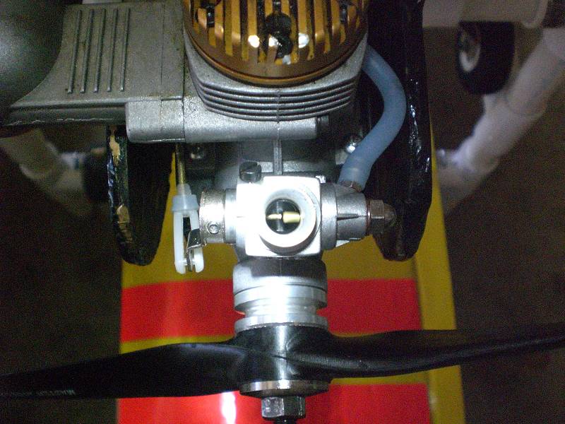

it was about five years ago, I have similar problem with my gms 1.2 . I saw when I prime the fuel goes to carb but goes back to the tank when stop primming. what i'v done was installing one way valve before carb inlet. and it's working for me.

Can't believe this thread is still alive. I just put my old GMS .47 on a Spot On 50. The engine never did run very well. I drilled out the carb inlet and removed the remote needle valve and I am using an OS muffler. It is running pretty well now and it starts right up after it is warmed up. I needs a little more power though.
I am going to try a Vess 12x6 next flight. Wow that prop is light! My APC 11x6 is a little lacking - might need a bigger engine though for this plane.
The check valve looks like a good idea adji. I hate when it does that. I wish I would have thought of it when I was running little Norvels.
