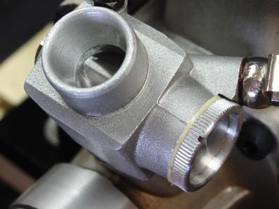

I have a Moki 1.35 that I'm trying to break in. Motor will be running fine(real rich) then just die. I ran 3 tanks of fuel through it today, died 3-4 times each tank. It's mounted on stand and I was using a cline pump. Any suggestions.

Try removing the Cline system until the engine is thoroughly broken in. The tendency to die is probably due to over-heating, also be sure to use an OS type "F" plug --- try richening the idle disk slightly --- try adding a few extra ounces castor oil to your fuel
Hope this helps; however the Moki 135 carb has been known to give problems !

Engine would't hardly run at all untill I put on the cline pump also when engine is cool enough you can hold on to the head & cyl. It's warm but not enough to burn. I've messed with low side, doesn't seem to make much difference. If I richen much you can't start it. The fuel I'm running is 20% oil, byron

I hope you are FAI (0% Nitro). My Moki's don't run will with over 5% nitro. I have had good luck with a K&B 1L plug. Also break-in takes a lot of fuel but then they run great.

5% max for the Moki, unless you want to chase the needle forever. I would take the cline off until you get the engine running properly. The K&B 1L or any other cold plug should also be used. The low end should have a great impact, if you are not getting much of a change pull the disc out and make sure the metering holes are in alignment. I've found quite a few need to be shimmed to work properly.

SA FLyer- My papers came from horizon. Paper doesn't talk about turns on needle valve but talks about 7000 rpm. I never checked the rpm while trying to break it in. My motor was made in 2000 I think. I bought it new from a hobby shop. Running 16x8 apc, 20oz tank mounted slightly higher than your recommendation, brisson pitts style muffler, moki plug, byrons10%with 20%oil. I can't change fuels yet, can't buy anything else locally. With the engine running rich it will die like you flip a switch, no warning. You talked about checking with guru, I'm one of them. Shows what I know. Any help would be helpful. Thanks
WHAT ABOUT THE PLUG SA FLYER MENTIONED? THE PLUG THAT CAME WITH MY 135 WAS A PROBLEM. USE THE OS F PLUG AND TRY AGAIN. THE INSTRUCTIONS THAT CAME WITH MINE GAVE THE HS NEEDLE VALVE ADJUSTMENT.
I threw away the plug that came with the Moki 1.35 and, for now, cannot remember why I did that. Because of the compression of this engine, a hot plug similar to what is used with 4 strokes was recommended. Find any other plug to rule out the plug as the problem.

I finally got enough spare time to get back to my 1.35. The only thing I really changed was the plug. Went to OS F plug. Ran 60 ounces through it and never had a problem. Think its time to put back in plane. I have nice idle and it transitions pretty good. Not instant but just a touch rich. If I lean it any more its harder to start and it acts to lean on the low side. Thanks to all who expressed their opinons, they were alot of help.

Was at the field today and a fellow flier had a new Moki that would not run in the proper direction for anything. I went home and got the carb off of mine (been down the awful carb road) to try, and the same thing. This engine will run and transition beautufully in reverse?? I'm decent at getting an engine to perform, but this one won't even run. Is there a way to tell if it was meant to run as a pusher or something? He was frustrated and disappointed to say the least. I am going to make this a seperate post but wanted to put it here first. Thanks_bob

SA flyer- Didn't have to go that far. Looks mine will do fine without it. It may change later but for now its good to go. Thanks As far as backward- first question- are you flipping it backward against compression? As far as I know mine has never started and run backward. I've had smaller engines do it but only when I flipped through right way.

didn't notice it mentioned...with the Cline regulator, the regulator has to be AS CLOSE AS POSSIBLE to the carb, 1/2" or less is great!
Also, firm believer in the K&B 1L plug...

Turns out that my buddy must have a different crank in his engine
When put side by side, my crank opens at just before compression at TDC, and his is past that point and is closed. Very odd to say the least. I took the entine out of my plane and let him use it to get his Aeroworks Freedom 3D going as I am not flying mine right now. These 135's cause alot of wasted flying time as far as I can see_bob
