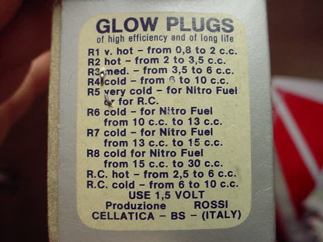

being relatively new to rcu, this subject has probably been covered every vear since the forum was set up, please humour me- where can you obtain a list of types and specifications for glow plugs? and perhaps a list of manufacturers recomendations , heat ranges etc.are there any hard and fast rules or is this trial and error .we fly here in uk in all weathers except rain of course and seem to be affected temperature dips? we are using enya n03 plugs in the 2strokes and os8 inthe four str!okes all comments please[:-

The Enya plugs are occasionaly seen, They are somewhat expensive. You see them in four strokes about as often as 2 strokes.
The plug of choice for the four strokes is the OS "F".
The OS #8 is sometimes seen in 2 stroke engines but the OS A3 is much more common due to the cost.
There are complete lists of popular plugs and how the heat ranges run on here somewhere?
One company's hot plug may be colder than another's cold plug. There are no set standards. About the only thing you can rely on is the heat ranges within a certain brand.

Here's the OS, and the Rossi glow plug specs.
ID:	222822   Click image for larger version

Seeing you're in the UK you might like to look at FirePower plugs at http://www.modeltechnics.com/glowplug/glowplug.html and follow the link to the FirePower Leaflet for test results on different heat ranges. But as Jim said, there are no standards and no cross references between different brands like there is for car spark plugs.
