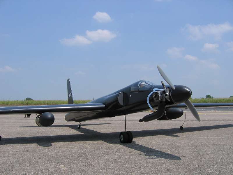

Here's another solution. I went off and bought a MAC replacement muffler for my TT Pro .36. The muffler is one piece and about half the weight of the original. I also got a nice jump in power. That little .36 is more than enough motor to haul around my sport scale U-2 that measures 95'' span with retracts and two cameras on board. Whole rig weighs about 7lbs!

Now thats a cool looking plane. With a 95" span I bet it is a ball to deadstick!
