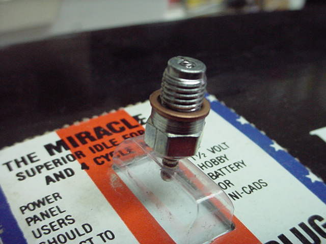

how would a 2-stroke engine run with a 4-stroke plug in it? i have lots of these "miracle" plugs that say 2 and 4 stroke but i think they are just 4 stroke plugs. i have an os .46 ax and i just put one of those plugs in it and it will run fine but won't idle... is the plug too cold?

Just use an OS #8. I have used the OS F 4 stroke plug is some 2 strokes, but they were bigger 1.40 pattern engines, they seemed to like them better for some reason.

4-stroke plugs tend to be hotter than most 2-stroke plugs. Some larger - more than 20cc - engines often run better with 4-stroke plugs. When used in smaller - ie .40 size engines - with 10-15% nitro content fuels, the plug might not last long.

That plug is fine in a .46 engine, the first engine I ever used one in was an OS
.46....it made a crappy engine run real nice. They really work well in inverted
applications too, because it has an extended tip, and does not drown out easily.

that is wonderful news! as soon as i finish building my ultra sport i'm taking the o.s. out of my girlfriend's trainer and putting it in the ultra sport inverted. guess i will stick with these longer plugs for that reason. she's getting the crappy tower hobbies .46 [sm=tongue.gif] now i'm trying to figure out my idle problem... i wish i was better with engines and knew how to fix these things myself! anyway, maybe y'all can help me on this one. i took out her trainer 2 days ago to fool around with and it wouldn't start, then realized the plug had burned out so i replaced it with the miracle plug... still wouldn't start. then i realized the bigger needle valve (don't know if it's low- or high-speed) was turned in all the way closed, so i turned it out to what i thought would be an acceptable setting.
still won't start.
primed the engine with my finger over the muffler and flipped the prop a few times.
it started! after it got running i leaned out the big needle valve to max rpms and then richened it a few clicks like i always do. it transitioned perfectly, revved up to normal rpm then when i brought the throttle back to idle, the engine ran at a higher-than-normal idle rpm and slowly lowered until it finally died, which occurred about 10 or 15 seconds after i brought it back to idle. i started it again and had the same problem over and over again, so i just came home

It sounds like your low speed needle is set too rich. Turn it in 1/8 turn at a time
till the idle improves. Once you find the sweet spot, the engine will run like a top.
Be sure to reset the high speed. Peak the engine all the way to highest revs,
then open the main needle until you hear the rpms drop a little.
