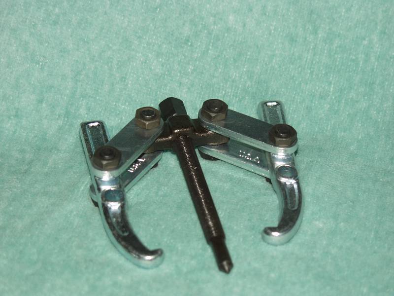

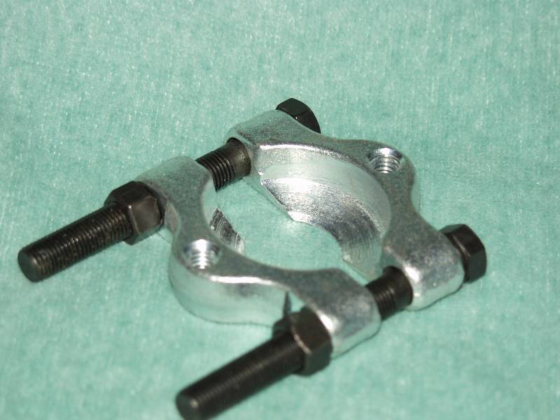

I use the pullers shown. Sometimes a little heat on the hub and maybe a tap on the screw of the puller with a rubber hammer is needed?
Enjoy,
Jim

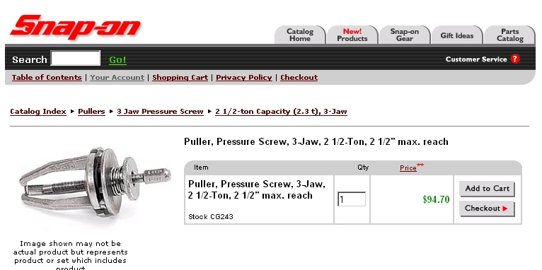

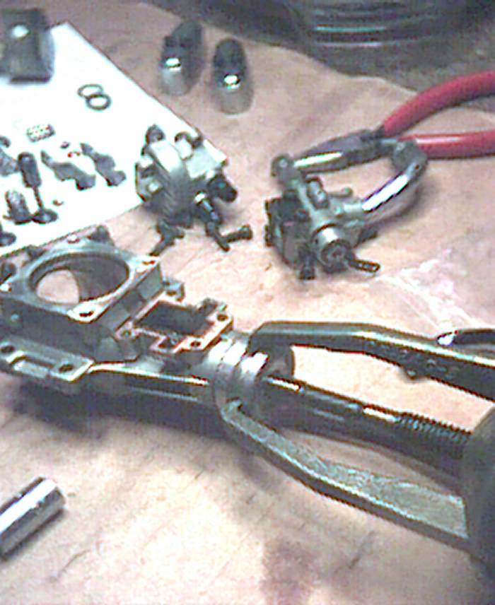

Map;
Here's the one I use.
Bill.

Pe:
The locking taper ( 10 degree ) was a deliberate choice on the four stroke engines, it gives that added bit of prevention against throwing a prop. On a two stroke engine with its lower tendency to backfire the non-locking tapers of 17 or more degrees angle are fine.
With my puller I've never had to use any heat - you may have noticed it's rated at 5000 pounds screw pressure - but it is a lot more money than could be justified for casual use.
Bill.
