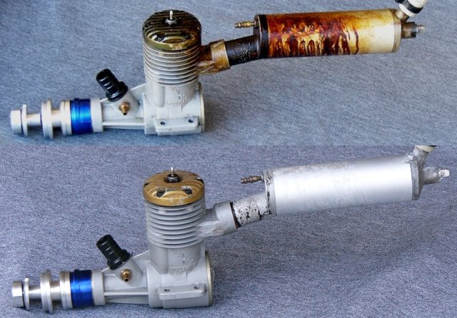

how to remove engine varnish
There has been a ton of posts on this using crock pots and anti=freeze, Being its small a guess might be put it in a jar with some
antifreeze put it the sun (sort a sun tea type thing) after a day or so might work that way do not need a crock pot which becomes
worthless for food prep after this use martin

I just cleaned 2 of my engines with acetone and a small wire brush. It got evey bit of oil varnish off and they look brand new. The wire brush I used is the size of a toothbrush . I can't remember where I got it but it gets in the cylinder vanes and tight spots and did not scratch the aluminum.

Hello; Handcleaner and a toothbrush, takes about 10 minutes. About the (relative) toxicity of antifreeze; I was a mechanic in a logging type situation, it was common practise to taste the leak to know what the fluid was. I don't know exactly how much antifreeze I "tasted" over the years, I don't recall any side effects. not to mention 90 weight,ATF,15-40, and maybe even a little battery acid. I guess that dates me.
I recently tried the antifreeze method on a Saito muffler myself. It didn't work so well for me. Lots and lots of elbow grease was required. Even had to pick at some hard deposits with a dental pick. Left it on overnight just like was recommended. I dunno. Just didn't work. Does it have to be new antifreeze straight from the jug? Cuz it wasn't. [sm=rolleyes.gif]
"I don't know exactly how much antifreeze I "tasted" over the years, I don't recall any side effects. not to mention 90 weight,ATF,15-40, and maybe even a little battery acid. I guess that dates me." I don't think I'd taste the leak if I drove a port-a-pottie truck.

[b]It isn't the antifreeze that does the job, it's the additives. The additives are used up over a period of time, and whether used as engine coolant or engine cleaning it has to be replaced.
So in your case, T&C, try some fresh for your next try. Do not get the "Environmentally Friendly" type, along with the propylene glycol replacing the ethylene glycol it also has a much milder additive package, really doesn't work worth a rap.

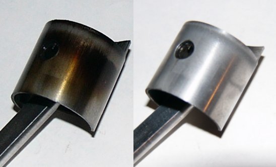

I've had very good results using dishwashing powder although I haven't tried dishwashing liquid yet. I dissolve about a spoonful of powder in boiling water then let it cool until it's just barely comfortable to dip a finger in. The engine in the photo only needed to be soaked for maybe 10 minutes but the muffler took quite a bit longer because it had badly baked on castor. The piston only needed a few seconds before all the varnish rubbed off using my fingers (that's after about 30 hours of running in a 4 stroke). Because it's designed for washing dishes it's obviously not poisonous

The principle ingredient of anti-freeze is glycol. The glycol family are fairly strong solvents. I had always presumed that this was the reason the anti-freeze method works. Interesting that William Robison says it is the additives, any idea which one?

I base this on practical experience, not laboratory testing. When working with heavy trucks we had a cooling system that held some 40 gallons of water/glycol mix. Annual replacement of the antifreeze in a fleet of several thousand units would have been a healthy expense all by itself.
For reasons I wwont go into here, diesels are more prone to damage from cooling system contamination than our gasoline powered cars, so the protection was important.
By using a product from the Nalco Chemical company called "Nalcool 2000" in the cooling system, adding one pint every 16000 miles we kept the inside of the system looking factory fresh.
My conclusion from this was that the glycol kept doing its job, but its job wasn't cleaning the system. The Nalcool replenished the cleaning ability.
Further note - when we would take an owner's unit on contract maintenance one of the things we did was a coolant check. Dirty system? Add Nalcool, cleaned it right up.

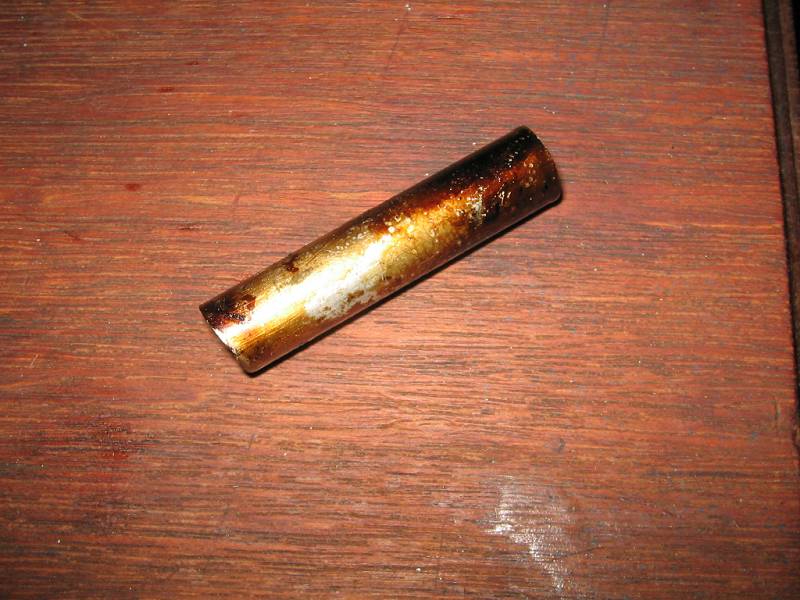

I would try a scrap piece of aluminium with the potassium permanganate before throwing your engine in it, I have a strong potassium permanganate solution I made up at work, I will see if I have something to try clean in it tomorrow, I'll tell you how it goes Bill.
If you get it on your hands it stains them brown and makes you look like someone who likes to smoke the herb, so watch out. Also it can be explosive if mixed with petrol or other hydrocarbons and I think that combination is shock sensitive to.
Here're the subjects A piece of ally tube covered with castor and cooked on over a gas stove till golden brown, and a heli muffler

Thanks for testing the potassium permanganate.
First idea is that the Nalcool 2000, in spite of the very similar color, did not have potassium permanganate in it.
Additionally, the Nalcool did not have the slippery/oily feel of a soap, so I think trisodium phosphate also was not a part of it.
But a hot solution of TSP might be worth a try.

Not a problem Bill. I will ask around the building at work see if anyone has some to try, but will probably only be next week, I am off tomorrow and Friday.

If your pot is anything but bare stainless steel or Pyrex, don't use it later for cooking. The glycol can work its way under a teflon coating, and it tends to bind to aluminum remaining poisonous for later food use.

I had been concerned about silicate deposits from the antifreeze being left on the model engine like they are left on the inside of automotive engines so I consulted with a cooling engineer at Cadillac about it. He dismissed silicate formation in such a short time but focused in immediately on the glycol as the solvent involved.
