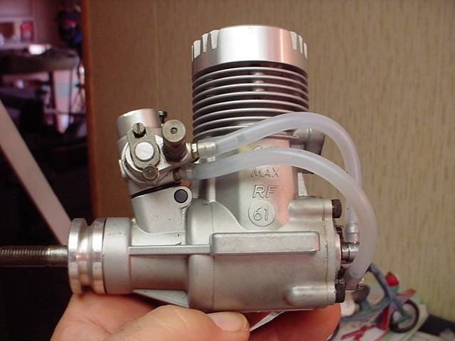

Can someone out there provide me with a copy of the manual for a 61, mainly I'm looking on the carb's adjustments. I been to OS website trying to get info on the 7L carb, like I did for a 4D carb, but to no avail. I'll mail anyone a self-addressed envelope, with postage of course, for a copy of their manual. If you can help me out please e-mail me at

Loosen the center allen, and turn the top screw to the 12 o'clock position.
( Straight up ) Turn the main needle out two turns.....
....it will start....and you will be pleased with the way it runs !
Adjust the top screw left for lean, and right for rich.

........the top screw (concentric ) is the low speed adjustment.
The center allen is the "lock"....the lower screw is only a guide.

The O.S. Max #7L carburetor does not have a midrange adjustement. Just a high-speed needle and and idle mixture control.
The socket head screw in the middle of the carb only holds the steel yoke onto the mixture control assembly. There is no adjustment. The steel yoke has an oblong hole in it that keys to the mixture control assembly. The socket-head screw just holds the yoke on.
The hex-head scew at the bottom keeps the mixture control assembly from falling out of the carburetor. There should be a small steel washer between the carb body and the yoke with the head of that screw in contact with the steel yoke.
The eccentric-head screw at the top adjusts the idle mixture. Turn left to richen the idle, right to lean it. It doesn't take much movement to affect the idle mixture. That screw rotates from 9:00 o'clock to 3:00 o'clock. 12:00 o'clock is the starting point. Usually, it winds up at the 1:00 o'clock position or so when the engine's been properly-set. That assumes that the high-speed needle's set to just rich of peak RPM.

Yes, Brian the 7L....the 7D is the big carb from the FSR series.
Pic #1....The lower hex head holds the assy in the carb and acts as a guide.
The allen fastens the arm to the center portion, and my mistake....it doesn't
have to be loosened. The top screw (concentric) when turned left or right
moves the arm which is fastened to the center brass portion by the allen
Rocking the center brass piece left or right makes the adjustment.

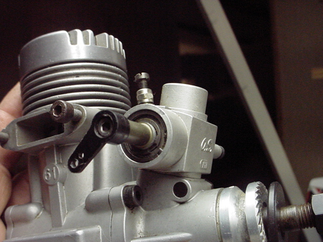

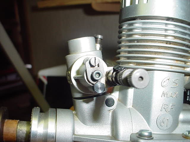

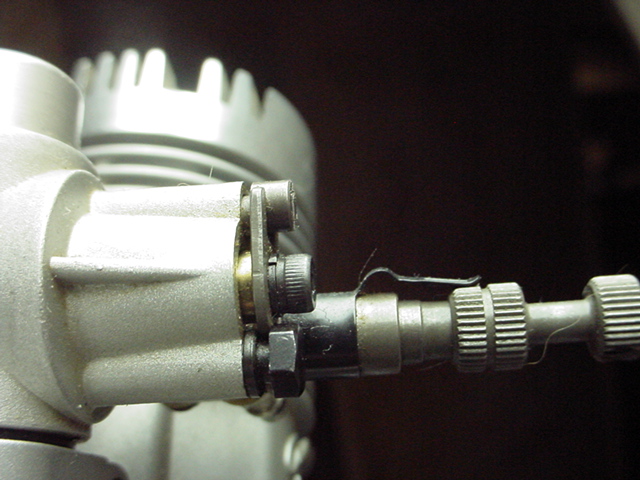

Pics #2, 3, and 4 are the 7H carb, which is similar to the 7M carb. I have
never seen the 7M....but I have most of all the others on OS engines. This
is one of the few with the mid-range adjustment....the only one I have. This
one has a strange throttle arm on it. I think it was a helo engine, but I'm
not sure.....it's on a ringed .61 FSR engine.

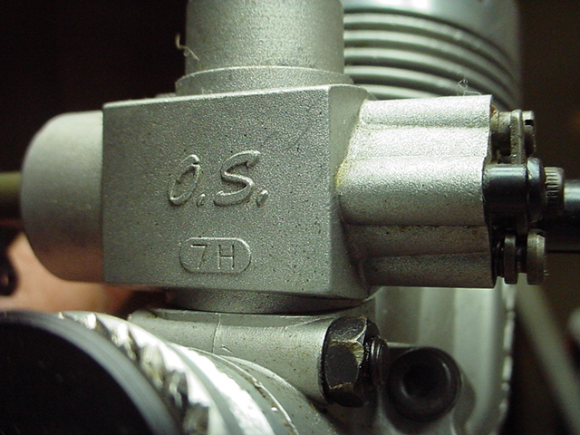

The model 86 carb is another variation....for the pumpers.

The O.S. #7H carb was originally a heli carb, but was also on aircraft engines, and does have a midrange adjustment. The bottom screw moves the idle mixture assembly in and out to adjust he mid. Like the idle mixture adjustment, it doesn't take much of an adjustment to affect the midrange.
