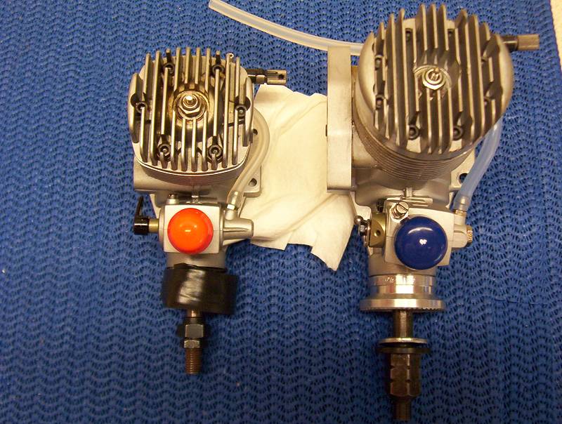

I like the .91FX for a 25oz motor and the 108fsr for a 33oz motor (weights with muffler). Have not had a G90, but I do have a G75. From the reports I have herd I am not sure the G90 will pull quite as hard as the .91FX. This makes no sense and is more likely to do with a stifling stock muffler?
My .91FX turns a 15 x6 apc 10,300 with stock muffler & baffle removed(or pitts) and 11,300 with an Ultra thrust.
My 108FSR & j-tec turns 16 x6 apc 9,600 and a 17 x6 apc 9,250 --only turns a 15 x6apc 10,500 or 200 faster than the .91FX (back to back test same fuel same prop).
