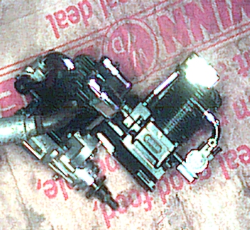

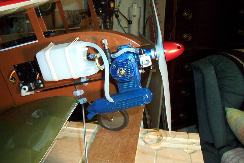

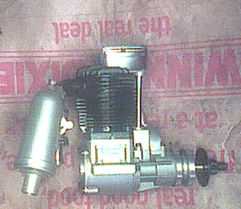

[b]Examples:
Some are oven baked enamel, some Imron, I've also used rattle cans. Done correctly they all hold up well.
Bill.

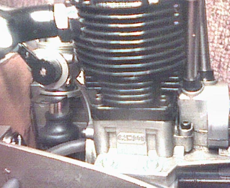

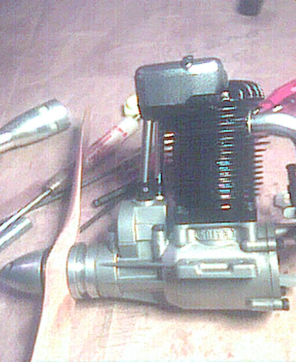

{b}HB 25S engines. I have two of them.
Bill.

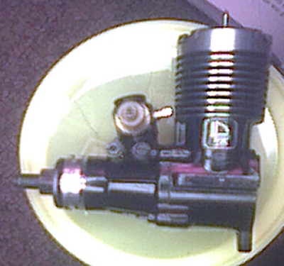

I have painted two mufflers for O.S. Max .25 LA's with paint made for brake calipers (good to 900 degrees F) I found it in a rattle can by "VHT" in auto parts stores. I have about 2 gallons of fuel through one and it has help up without any problems at whatsoever.

Old 09-30-2005 | 03:51 PM
  #39
AMB
Joined: Jun 2003
Posts: 6,748
From: winter park, FL
Default RE: Engine turned charcoal grey
Looks better than the LA factory finish martin
