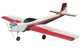

When my engine is in a vertical position, it shuts off. Why does it do this? Its not because of the pressure failure in the fuel tank, there was a slit in the fuel line, but its fixed and still, the engine shuts off in vertical position. I think its a leak or a loose screw, and I'm taking it apart, help me. What do you guys think?

Generally, if your engine is quitting in flight....it's because it's leaning out
and overheating. Lets assume the fuel system is OK. You might have a
slight air leak....the carb must be tight down onto the o-ring or it will
leak air, and give tuning problems.
If you are not using a fuel with plenty of castor, your engine will run hot.
That's just a fact. If your engine is over-propped, it will over heat. If the
engine is mounted upright, it can overheat in a climb from leaning out.
Using the wrong glow plug can have an adverse effect on the engine. If
the engine is cowled, it may not be receiving enough cooling.
I wouldn't take the engine apart unless it has suffered compression loss.
FBD.

There are so many possibilities. One generalization we can make is that the engine is dying when vertical because it leans out in that position. Flyboy Dave mentioned low compression. I agree with him, there's no reason to take the entire engine apart, unless you have low compression, which might give the engine marginal fuel draw, causing it to die when vertical. Usually, a low compression condition will make the engine hard to start and not idle very well, if at all.
A more likely cause would be the needle valve adjusted too lean or an air leak of some kind. The needle valve should not be adjusted for maximum rpm. It should be a little richer than maximum rpm, perhaps 300-400 rpm less than max. would be a good starting point. Others might disagree with that number, but everyone will agree that it has to be somewhat richer than max. rpm.
An air leak could also cause marginal fuel draw, which would be worsened in the vertical position since the fuel would have more vertical distance to travel. Air leaks usually occur in the following:
1) Needle valve threads loose in the housing (can sometimes be cured with a short piece of fuel tubing around the needle valve to make a seal where threads and housing meet)
2) Carburetor to engine joint (try a new 0-ring, and pushing down on the carb. while tightening the draw bar)
3) Engine backplate leaking (try a new gasket or 0-ring, and tightening the screws)
4) Leaking seal on the front engine bearing (requires disassembly and replacement of bearing/seal)
One more thing to check. You said you removed the fuel tank, but you did not say if you DISASSEMBLED the fuel tank. I suggest you check to make sure that the pick up line and the pressure line are not reversed, that both lines inside the tank have no holes/slits, that the pick up line did not get jammed/bent forward and stuck that way from a hard landing or sudden stop, and that the pick up line did not get disconnected inside the tank.
I know some of this is very basic, so forgive me if you already know it. I just don't know how much you know, so I'm trying to cover all the bases.
Good luck, and please keep us posted so we can all learn what worked and what didn't for future reference.

You may not be getting enough pressure to the tank. Please make sure that the nipple on the tank is clear. Also make sure the line from the muffler to the tank is clear, with no kinks or restrictions of any kind. Do the same with the tubing in the tank. You may also need to see how long your fuel lines are. Shorter is better. If the tank's too far aft, there's a problem.
What size tank? Shape? Larger than 10 oz. is too much, and can cause fuel draw problems. Some shapes just pick up vibration better is some models. Make sure the tank is well-insulated against vibration...in some flight regimes, vibration can change enough to excite the fuel in the tank to pick up air.

Also - the Tower 46 is a powerful engine, albeit many people have trouble tuning theirs. Mine took a whole summer of running rich before it really loosened up and started acting like it should - it seems that it takes a lot more break-in than my other ABC engines have.
I also had an airleak around the base of the carb , and possibly at the backplate. I RTV'ed everything I could, and locktited the threads when I put it back together.

YOUR THE MAN. I havent tried it yet, but yeah, duh. It worked fine all the time, until two days ago i biught the rubber extension for the muffler. Ill try to take it off. It makes sense though becuase it requries more pressure with the extension. It shuold be fine now. Im such a dumbass, why didnt i think of that.

Usually, a rubber extension will increase the backpressure a bit. With some engine/muffler combinations, that little bit of added backpressure is enough to make the engine overheat and quit. That my have been your difficulty...especially since it happened when the engine was nose-up...a condition that automatically causes reduced fuel pressure to the engine. Added backpressure, slight leaning, and the engine can overheat quickly. The slight additional backpressure would add to fuel pressure, but not enough to cause the engine to richen enough to prevent the quitting from lean. Nose down, the fuel would tend to "rush" to the engine, so you're getting a richening effect.
Glad to see you found your difficulty!
