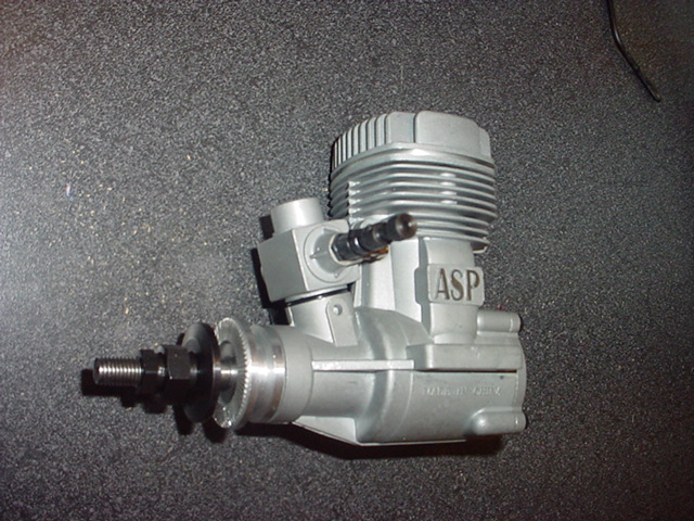

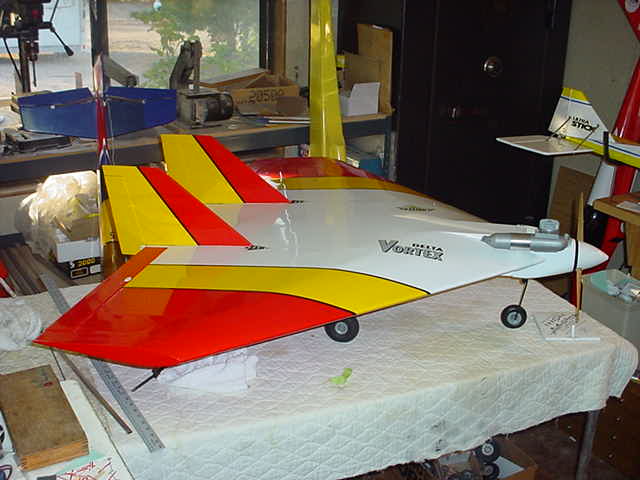

Go with the ASP at half the price....take the wife out to dinner.
I have that engine in a delta Vortex, it has plenty of power. It likes
5% nitro, a smallish prop, and a cool plug. It is a high compression
European type motor. If you want to run big props, you will have
to decompress the engine with another head shim.
