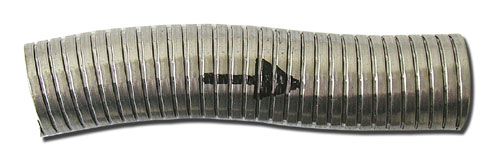

hi,
i have a mvvs 150 engine with 45 deg exit.
when i put it on the plane the exit of the tune pipe is lower then the fire wall of the plane so i heat up the
adaptor of the tune and bend it a little.
when i started the engine the adaptor break to 2 pcs and then i fix it and its broke again in another place.
i think that the heat destroied the adapter strength becu its alominiom.
does anybody have an idea for me?
thanks
nir

It should have been post heated in an oven to stress relieve it.

Hi Nir,
Please enter the [link=http://www.krumscheid-metallwaren.de/neu/shop.php?lang=EN]Krumschied web site[/link] and press the accessories tab.
I am sure you will find a suitable solution to your problem.
Among them are flexible pipes, like you were interested in.
Good luck.
Take a look at the other things in that site too.
