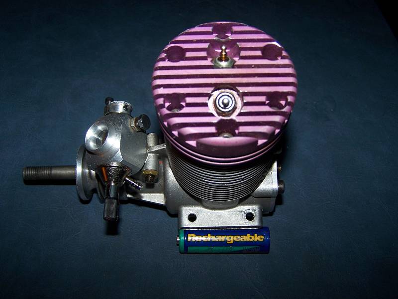

Hobbsy, I Got to agree with you some Webras are pretty good. I helped put a Frank Bowman piston ring in a Webra that from new did not want to hand start for lack of compression. That all changed with Franks piston ring! Capt,n[X(]
