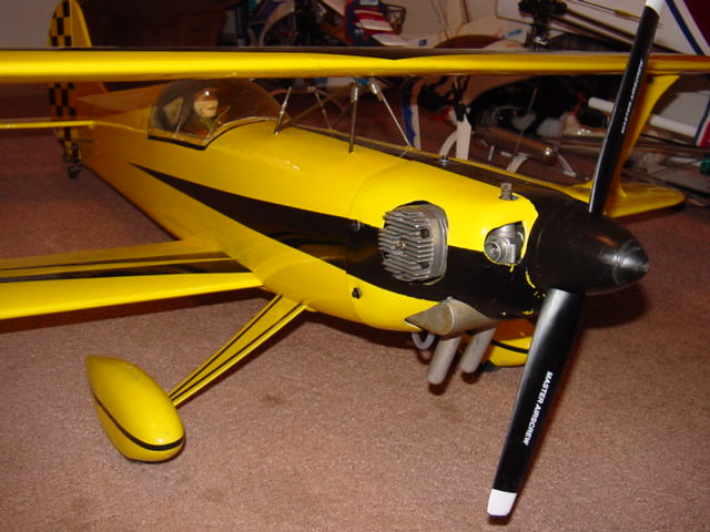

Old 11-18-2002 | 03:14 PM
Posts: 410
From: New Haven , MO,
Default Skybolt
I've got a pumped TT120 w/ 15x8 & Bisson pitts
Tanks on CG
Balanced perfectly
Kirk
