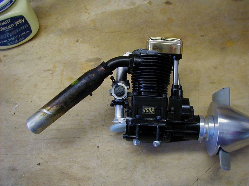

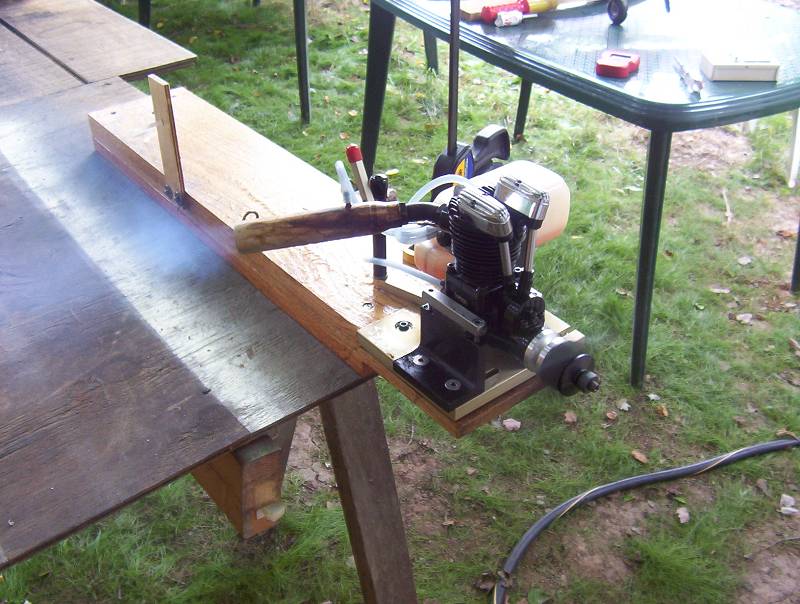

This is my early high compression 150, you can see the gold 150 just above the right clamp bar, I'll check today to see if its possible for the tag to come off. Just for kicks the engine is turning a Mejzlick 16x8 and running on WildCat 10% Premium Extra. My daughter got this one for me for Christmas in 1991, she paid $449.00 for it, they have come down in price, Thankfully

Hey, hobbsy I got one of them too. One of the best running motors I have.
