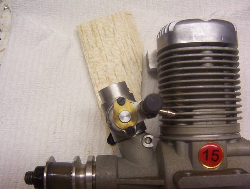

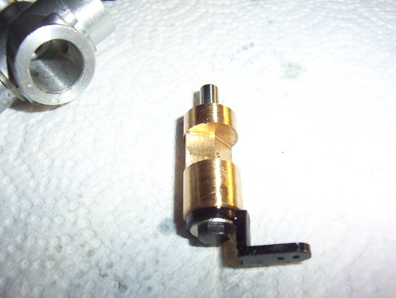

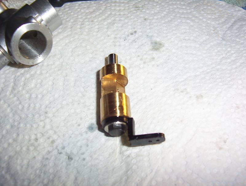

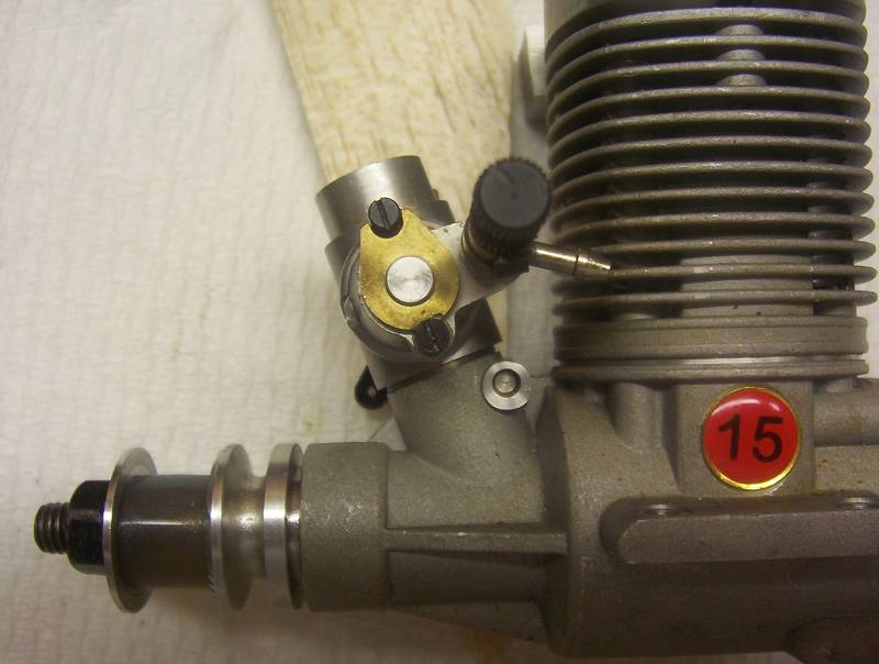

Here is one of the finest carbs I've ever had the pleasure to set up, it's on my MVVS .91. It has a simple wedge shaped butterfly that is tapered on the front and flat on the back creating a venturi, it is a metered carb and is as linear as an Irvine Jetstream and that's saying something. Unfortunately MVVS chose to discontinue it probably due to mfg. cost.

ORIGINAL: hobbsy
...Unfortunately MVVS chose to discontinue it probably due to mfg. cost.
Dave,
Cost may have been one reason for discontinuing production of this carburettor, however, the newer #3216/3219/3215, with all their various models and variations are probably as linear as the #3222 that your MVVS .91 sports.
The older versions of the same carburettors, had the blunt-end idle needle, that caused the mid-range to be awfully rich, with perfect top and bottom ends.
For a time, an upgrade has been offered (#3216-0253), using the new, tapered needle and a replacement nozzle, but the behavior of the new carburettor is incomparably better than the old, even upgraded version.
The basis of operation of an R/C carburettor is the fuel metering, done by several means.
The basic means is the tapered low-speed needle that moves further into a nozzle, as the throttle is closed (the barrel moves sideways along a guide), making the fuel orifice smaller and allowing the engine to suck less fuel, as it inhales less air, thus achieving a close to ideal mixture, at all throttle openings.
Some carburettors meter the fuel differently, like, for example, the Perry carburettor, the aforementioned #3222 MVVS, the Webra Dynamix and a couple of other designs. Even the so called low-speed needle, works in a different manner in different two-needle carburettor types.

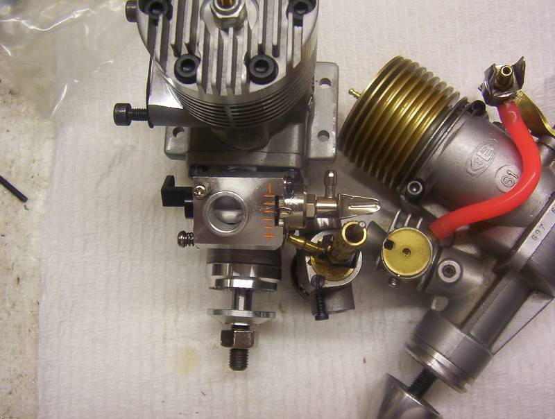

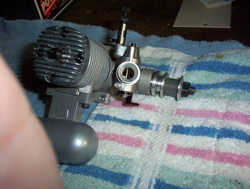

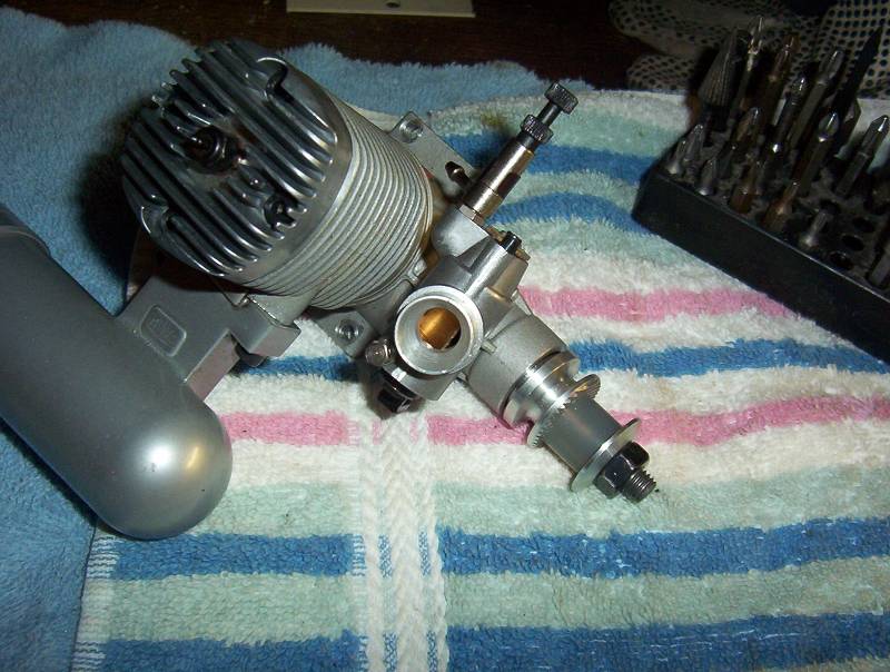

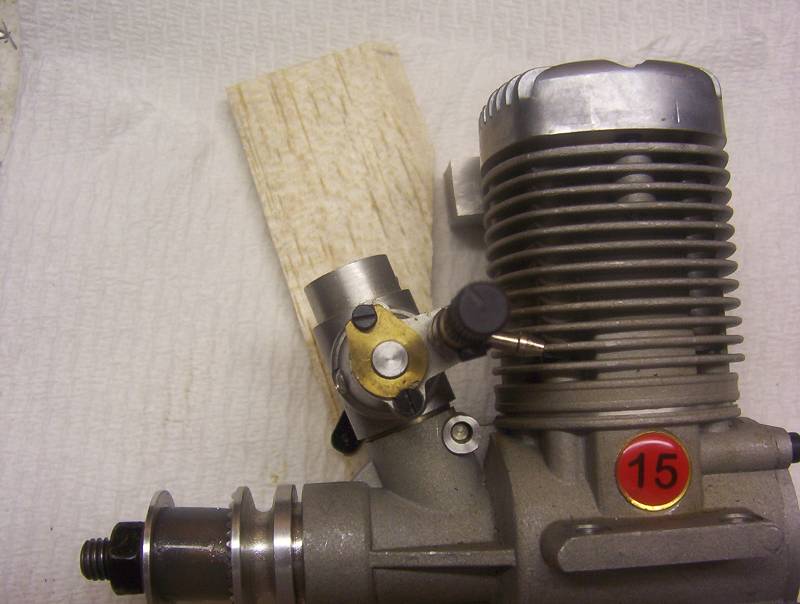

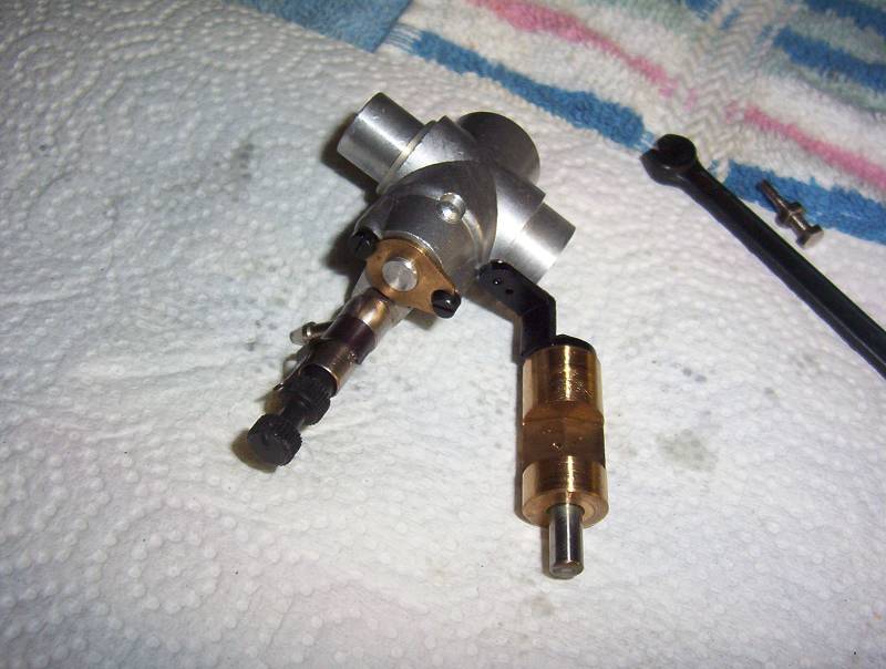

Here is a better look at how MVVS gets the venturi effect in this carb.

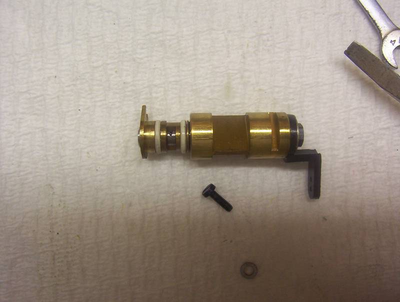

For Colin Stevens, Colin I dismanteled the MVVS carb to make sure of the direction for leaning and richening the midrange. Rotating the adjustment CCW==richer midrange, CW==leaner midrange. The carbs in picture #5 all have a common trait, small adjustment equals big change, minute adjustments are the rule of the day.
Pic. #1 full lean
Pic. #2 full rich
Pic. #3 where this one runs best
Pic. #4 full rich.
