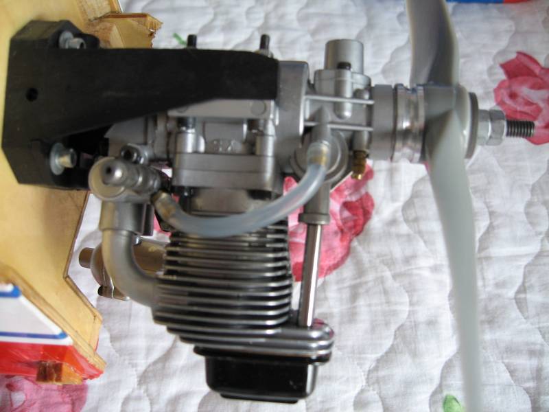

Hi there.

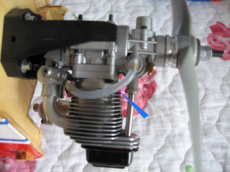

I have a YS 53FZ and also a great problem when running!!!From idle when i go to full throtle the engine stays on a very low rpm and slowly shuts off!???I checked for leaking pressure,wrong connections and diaphragm position!Also when i puss the diaphragm the rpm changes!
What is going wrong?
Does anyone knows sth?
I uploaded the photo of my engine,installed in a Greatplanes Extra.

What percent nitro fuel are you using?
Has this engine run well in the past?
Are you SURE the checkvalve is on the correct line and it is connected to the correct fitting on the engine?

Also in this picture you can see that this tube when i am going to start my engine by hand,fuel will not pass![]

Your engine is running lean.
Could be your needle valve setting
Could be regulator problem
You could have the fuel lines connected wrong?

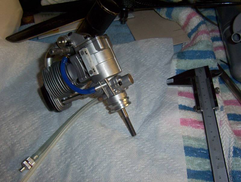

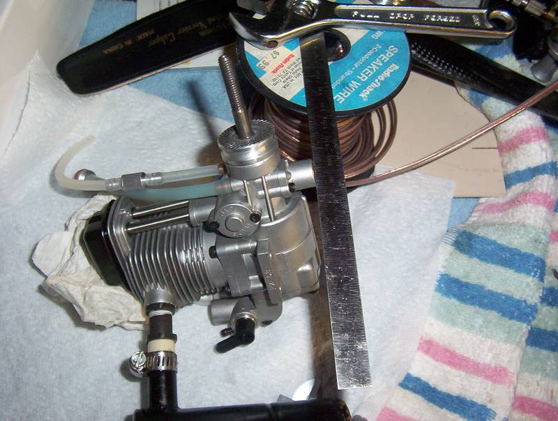

Kostas, here is the setup on one of my .53s, the LS needle is 1.5 turns out from gently seated and the HS needle is slightly less than 1.75 turns out from closed.
ID:	377542   Click image for larger version
ID:	377543   Click image for larger version
