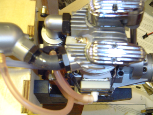

I am ready to mount a Cline Regulator to a QQ Yak. The plumbing directions are a snap. i am more interested in the actual attachment to the air frame. Do you mount it like a RX or batter pack? Wrapped in foam & zip tied down. Or hard mount it? i know it needs to be on the firewall close to the carb. What have you guys done?

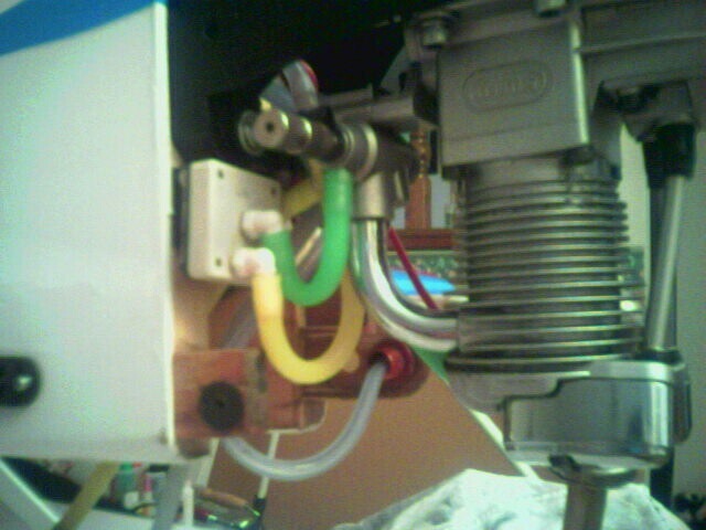

David, maybe this will help, the velcro is epoxied to the firewall and ive had it like this for a lot of flights and no probs

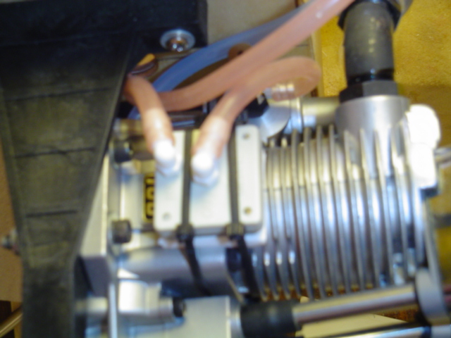

Joe, It's a Saito 1.80. I looked at the possibility of both the first responses. This plane has a big cowl but there is not a lot of room on the motor box. I also have the muffler in close to the bottom of the box. I followed your leed and mounted it to the engine this AM. Look at the pics and see if I am on the right track. I am going to run the engine this Sunday.
Thanks to you all,
David

Dave, looks good. Keep the tie wraps as loose as possible just to keep the Cline from shifting. The looser they are the less vibrations and heat transfered from the engine. That's what I noticed. Jim Cline also told me to try rotating the regulator 90 degrees if there are bubbles in the fuel line to the carb. He says that doing this puts the needle valve lever in a different orientation that does not get affected by engine vibrations (edit: as much). You may be just fine as is. Good luck. These are awesome gizmos.

Sorry Joe, I didn't notice pics of two different Saitos.

Gary Jeffers posted a Saito 100 if that's what you mean?

One more question. In pic one you can see the check valve in the exhaust line. Does this look like the right spot?

Default RE: Cline regulator mounting?
Precisely the right spot.
