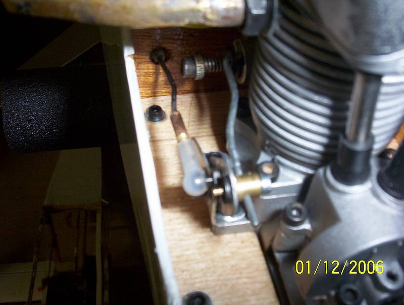

I'm attempting an engine swap in a 20 size Slow Poke. The old engine had the throttle arm on the left side of the engine well off the front/rear center line. The Saito .40 I'm trying to install has the throttle arm on the right side and much closer to the center line. My usual solution on a four stroke is to use a tiller bar mounted at the front of the engine bay, and then link back to the arm. I've already tried this with a 1/2" extension attached to the throttle arm with a ball link on the end (not shown). This was in an attempt to avoid sharp angles. There was also a ball on the tiller bar and a socket on each end of the link. The result of this set-up was a severe flexing of the plastic throttle arm and not much barrel movement. The sockets were well lube with a silicone lube. If anyone has experience with the Saito .40, or anyone else with an idea how to fix it, I would sure appreciate some help with a solution to this problem.

Throw the plastic arm away and make one out of aluminum. Get rid of the ball on the carb arm. Put a z bend in it and bend it to get it to line up with the aluminum arm you make. Use ez end with a set screw on the aluminum arm. Use the ball and socket on the throttle wire from the servo for isolation.

I got by with bending a horseshoe in the wire going to the thrttle arm. I used a Z-bend at the throttle arm. I used a slide clamp on the servo arm for adjustment. I've done it on several planes and seem to be getting away with it. I didn't use a tiller arm.

Jim, the throttle arm on this .40 is tucked back in behind the cylinder. I've done it your way a few times and it has worked out well, but it was a straight out and straight back type deal. I would have to put about 3 bends besides the "Z" bend for it to connect. I've tried this before and got too much flex. I'll make a run tomorrow and round up some aluminum stock to fab a set-up like Kimhoff's. If I can't make this work, I'll try all the bends in some heavier music wire than I now have. Thanks for the ideas.

Here's what I came up with. It works well with no slop or binding. I still need to trim the screws securing the bent link at both ends. You can see I'm a fan of the Frank LLoyd Wright philosophy of "Form Following Function". If I may say this, there is a place on the gentleman at Saito who designed this throttle arm where I would like to clamp a pair of vice-grips.

Jaka, if you mean turn the carb around, on the three small four strokes I own this is not possible. The tank prevents a straight shot at the throttle arm. I've hooked up quite a few four stroke throttles and this is the first one that has been a challenge. The plastic throttle arm is so flexible, I could only get a straight push to work.
