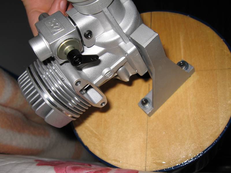

Also i have an OS 91 FX and i am going to break it in in my new Hangra 9 Corsair.
Do you know in what position should be the tank?
Should be in same height of carb?
Any pic?
