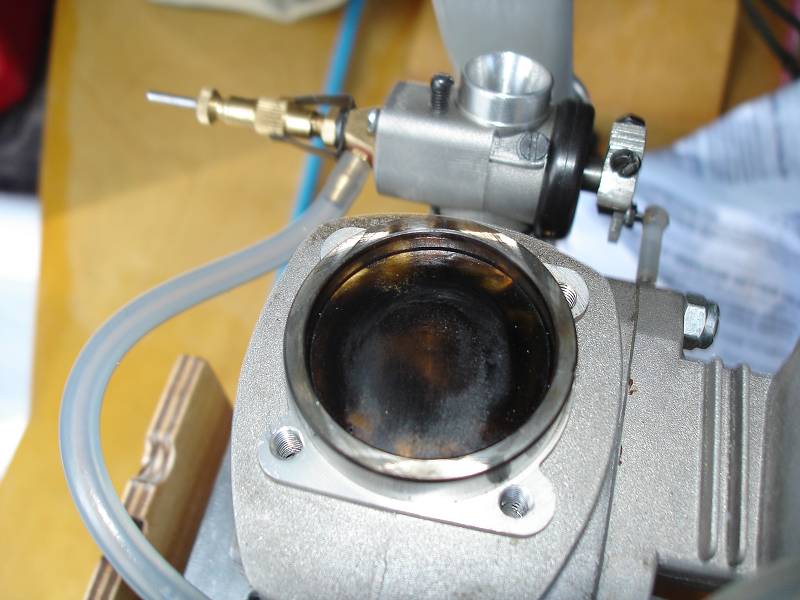

The fuel is fresh, bought about a month ago, and the engine has been overheated to the point that I accidentally touched my forearm to the head and received a nice striped burn. The overheating happened before I got the bubbeless tank. The previous tank would be good if kept full, but once it got to about 3/4 full, the bubbles would create a very lean condition.
I should take the head off and check the condition, shouldn't I?

What a horrrror movie .... Uuuups ?!?
This is a well fried engine ... It looks you better
forget using Nitro as soon as possible ...
Cheers,
Nikolay
Cheers,
Nikolay
#813
Hi crispyspa,
Cheers,
Nikolay
Cheers,
Nikolay

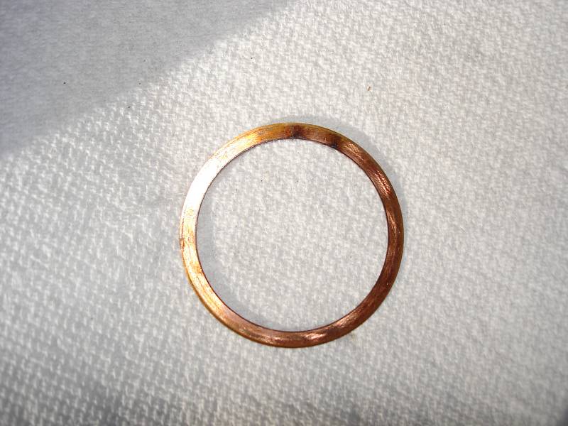

I think it might have been a combination of aerated fuel and a manufacturer defect, leaning on the defect side.
If you look at the copper head gasket, there is a burn mark that goes from inside to outside. That to me indicates a bad mating surface between the steel cylinder and the aluminum head....almost as if the sleeve isn't flat on top. You can see what I'm talking about in the second pic.
Anywho, I sent in the engine today, we'll see what happens.

ORIGINAL: NikolayTT
Hi crispyspa, What a horrrror movie .... Uuuups ?!? This is a well fried engine ... It looks you better forget using Nitro as soon as possible ... Cheers, Nikolay
Hei Nikolay, this is incorrect information. His engine may be fried but nitro did not do it. This engine is not like the other larger Super Tigre engines or the big Moki/Mark engines. This engine loves nitro. I have 3 of these, 2 Italian and one Chinese. All have run 20-30% nitro for many gallons with no problems including contests where reliability is the most important thing. I have run as much as 50% just for fun. This engine increases rpm with every increase in nitro, the idle gets better, midrange cleaner, acceleration better. The OS160FX does not increase rpm much above 15% nitro for contrast.
I am not recommending that everyone run high nitro.
Ithink more nitro will make it less likely the user will fry the engine. Why? Because more nitro makes the correct needle setting more broad, making it easier for inexperienced users to set the needle.

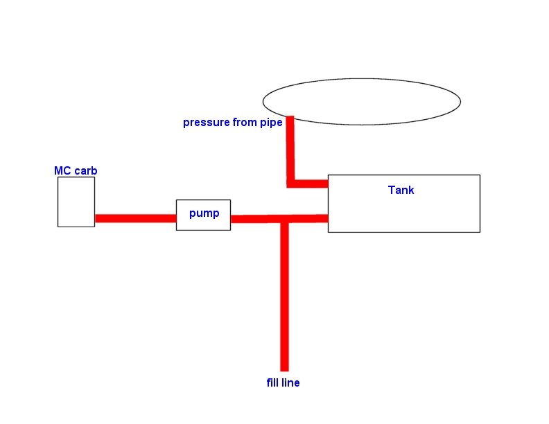

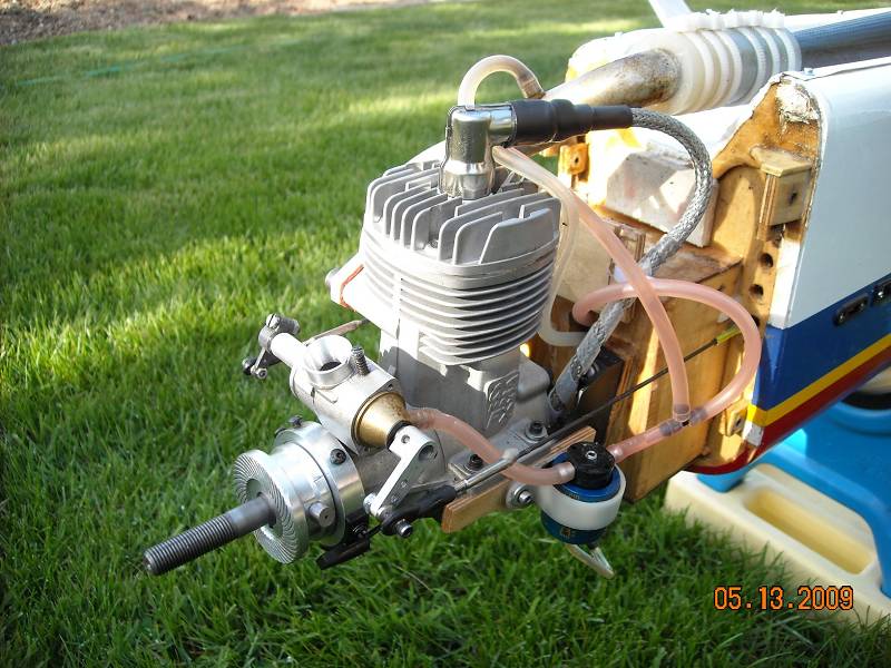

aerobear, I have a question about that pic.
If you are running a perry pump, why do you have a line running to the fuel supply hose from the muffler? Wouldn't that inject air into the fuel supply line?
EDIT: nevermind, the two hoses cross behind the spark boot making it look odd.
#817
Posts: 768
From: Tampere, FINLAND
ORIGINAL: crispyspa
You mean lower the nitro content for that engine or stay away from nitro engines all together? I think it might have been a combination of aerated fuel and a manufacturer defect, leaning on the defect side. If you look at the copper head gasket, there is a burn mark that goes from inside to outside. That to me indicates a bad mating surface between the steel cylinder and the aluminum head....almost as if the sleeve isn't flat on top. You can see what I'm talking about in the second pic. Anywho, I sent in the engine today, we'll see what happens.
that there are only four(4) bolts to tight the head of the engine. Surely one can maybe do it even with three(3)
but that is real tricky to do it right. Seems you have not got the head well pressurised; let see what the
dealer will tell indeed; please post it.

And also, please post the scheme of the fueling connections.

#820
ORIGINAL: NikolayTT
One seem stupid thing the manufacturer has done is (what was already mentioned by some other guys)
ORIGINAL: crispyspa
#821
Posts: 768
Seems your dealer admitted manufacturing problem. Cheers !!! You got a good dealer too !</p>
Then it seems right to suggest that you do not spend more money&time on trying to </p>
improve ST beyond its average quality and then buy a better engine for better </p>
performance, if/when needed. Still I think ST is a good one for daily and low-cost fun.</p>
