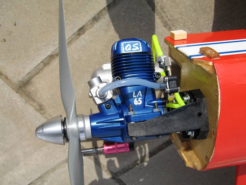

Hi all.
After a couple of mounths of thoughts and engine comparing,i bought an OS 65 LA.
This engine is from on installed in a Greatplanes Extra 300 ARF 40 size...
So,
today i run my first 3 tanks through it,and wow [X(] man,what can i say for it...
I AM IN LOVE WITH IT!
Mmmm,here how i begun:
I filled the first tank with fuel (10% nitro,18% castor-synthetic oil).
I opened the high speed needle 2 turns out from fully closed position.
And i primed it.
Closed then the throttle and then opened it 4 clicks.
I don't have a starter so i started my engine with a chickenstick.!
3rd flip and engine started with a big white smoke coming out from the exhaust.
I advanced right after that the throttle to fully open position.
Running rich and the throttle in fully opened position i run 3 tanks of fuel through my OS 65 LA.
I am really really pleased that this MAD engine will be better than best,as i expected to be.
To just mention,i have also an OS 46 LA,one and a half year old,and a NIB OS 91 FX.
YES YES,
I AM AN OS FAN,but...
why not to mention that?
Hehe.
Looking for your oppinions and your pics..
Kostas

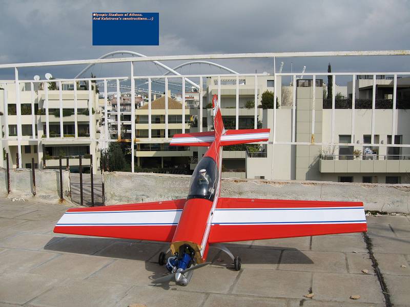

Also here are another 2 pics of my engine-plane.
Enjoy

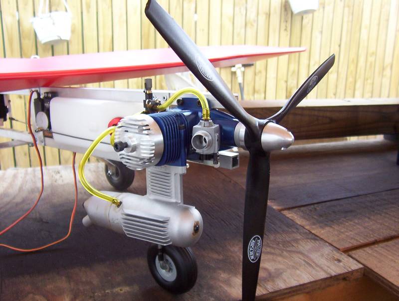

Now Kostas, think about it turning a 13x8 3 blade at 9,000.

I noticed that Tower was selling blue mufflers separately. Why didn't OS provide the buyer with a blue muffler to begin with? And a blue carb?
I'm glad that you like your OS .65 LA, Kostas. Statistically, someone had to. <wink>
