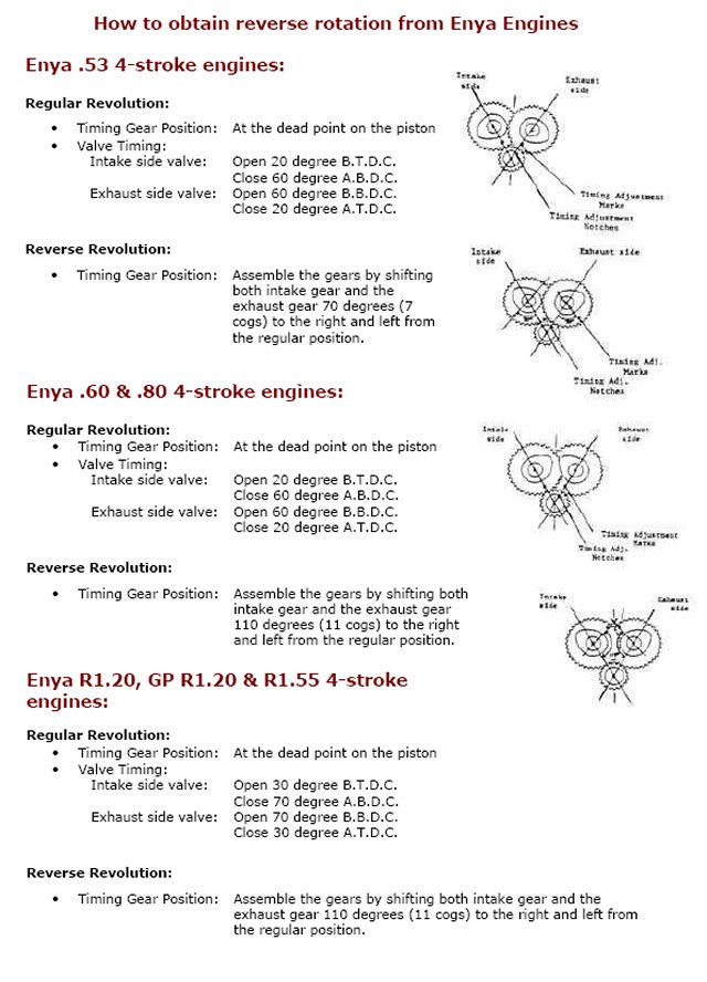

I have picked the finest minds on RC-Universe but still have an Enay .60 4C that will not run.
I have checked and rechecked the timing marks and they are dead on per instructions one of our memebers sent me from the MRC website. I have made some self inflicted mistakes along the way but I think they are all behind me now. The only thing the engine will do is run backwards for a second or two if I literally flood it.
I believe I have the cams in the correct orientation and at the correct timing but...
I am missing something.
Does anyone have any ideas?
Thanks!
JLK

You're right. The Enya has two separate cams but they overlap so the gear on one is out further than the other. Right now I have the one on top of the other (I hesitate to use the term overlap here) just as the .pdf file shows but I have intentionally reversed this and still won't run...
I'm really scratching my head on this.
Thanks for the advice!
JLK

Here is the page I sent to John, I got it from the Altech/MRC site. It's a bother to find, but if you want the URL I suppose I could go get it again. The reason I kept a copy because it's so hard to find.
Bill.

You can't attach a .pdf file, it has to be converted to a regular graphic format. the one I posted above is a JPEG file.
Tim:
Enya has three different set-up arrangements - your 120 is different from the mid-size John has.
Bill.

You will note the page I posted has no illustration for the 1.20 engine. the the best of the information at hand, the 1.20 is the only one that has the two lobes between the gears, the smaller engines both have the gears in front of the lobes.
Here's the pertinent section of your picture, enlarged and (I think) easier to see/understand.

Tim:
I notice also that your sheet gives 20-60-60-20 timing on the 1.20 while my sheet gives that for all BUT the 1.20, and the 1.20 at 30-70-70-30. And that's a lot hotter than the 20-60 timing.

According to the diagrams and pictures, he has the exhaust cam on backwards and in the wrong place with the intake cam.
He has the intake on top. The intake goes on the bottom with the lobe out. The exhaust goes on top with the lobe in?

John, the only difference between the illustration Bill provided and what you have in your picture, is the driven gear on the exhaust cam should be behind the driven gear on the intake cam. That is if I'm seeing it right.
