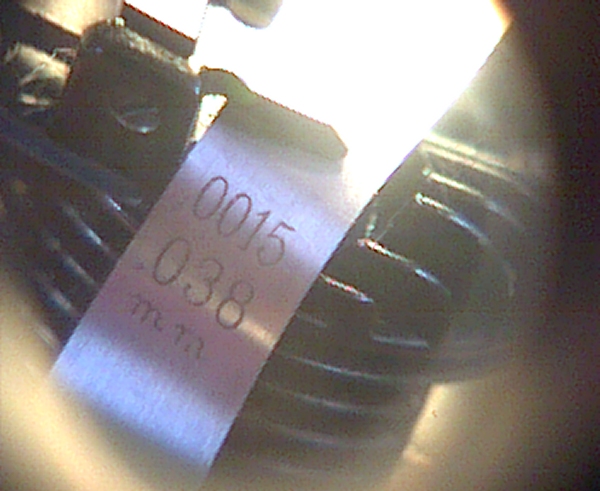

It could well be you made the problem worse by going to the 20% nitro. Depending on the age of your FA-150 you might have one of the "High Compression" versions, they can be really critical on nitro percentage. Try using some fuel with zero nitro, or at most 5% and see what happens.
Also, reset your valve clearance to 0.0015" at most - that helps too. And yes, that is one and one half thousandths inch, not fifteen.
Bill.
>>EDIT to add picture. wr.

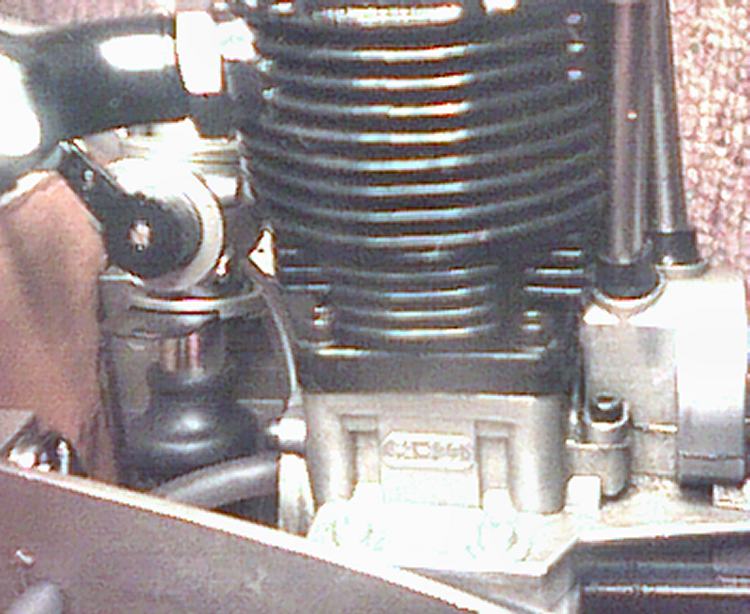

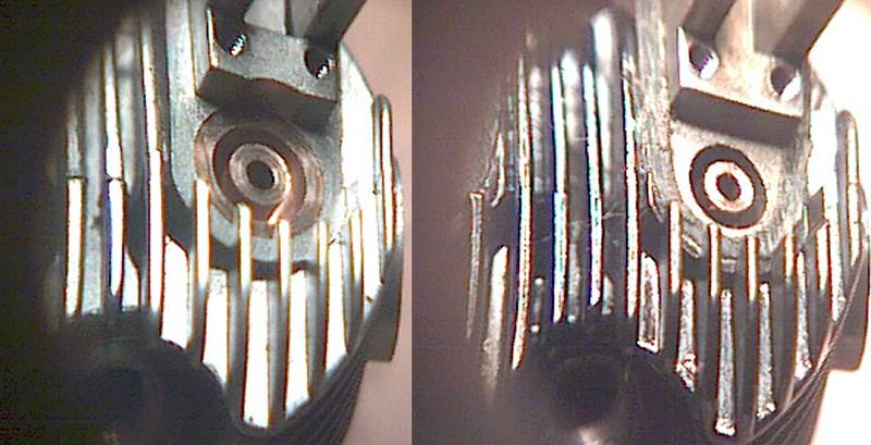

Given reasonable treatment, it's just about impossible to wear a Saito out. Prolonged running with preignition and/or detonation (not the same thing) can damage the rear crank bearing, and eventually loosen the rod fit on the crank pin. Looking in the back of the case if all you see is oil squeezing out of the rod bearing it's OK. If you see an open gap inside the big end of the rod, replace it. I can't say I've ever heard a rod knock in a Saito, just too much other noise.
High or low compression? With the rocker cover off, look at the top of the cylinder around the valve spring. If you do not see a brass ring it's high compression. The cylinder fins - if they are too big to get the cam cover out without pulling the cylinder, it's high compression. These both show it's the ABC version instead of the later AAC engine. Actually has a choke, probably high compression.
The early AAC engines were also high compression, so lack of the ABC cylinder does not mean your engine is low compression, but there were very few HC engines with the AAC cylinder.
The 18x6 prop might be a little much, as Jim said, it's right on the high end of the permissible range.
Pictures:
1) Comparison of ABC and AAC spring pockets, AAC on the left.
2) Cylinder fins over cam box, ABC
3) Smaller fins, AAC.
Bill.

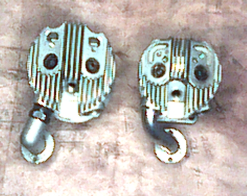

All but a very few of the "Big Block" Saito engines have the screw in intake pipe. The one in the picture was a very limited production version of the FA-120, high compression, wild cam, free exhaust. The one in the picture is the very first of the big block "S" type engines, possibly no more than a couple hundred made.
Bill.
Old 02-28-2006 | 01:36 PM
Posts: 20,205
Received 20 Likes on 15 Posts
From: Mary Esther, Florida, FL
Default RE: knocking Saito
More on the cylinders and intake pipes.
All the FA-150 and FA-180 engines have the cast intake with screw-in attachment. Only the short run of the first version FA-120S had the curved pipe.
This picture shows the ABC FA-120 cylinder on the left, and the first production FA-120 AAC on the right, it's the FA-120S.
Bill.
>>EDIT: This also shows how much larger the fins of the ABC cylinder are. wr.
