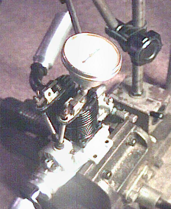

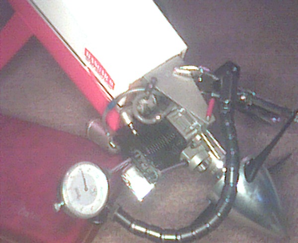

Doggie:
A feeler gauge works fine, but if you want to get fancy...
Bill.

Loughbd's "...not that critical." statement and Carrell's "Go /No Go" will work, but for maximum power from the engine and longest life of the cam and valve gear stay with the minimum clearance.
The reasons have been discussed too many times to repeat here.
Bill.
