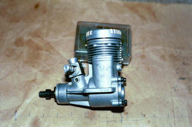

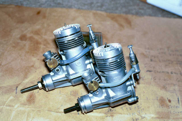

Loughbd said the Fox 35 had been in production for 58 years. That statement has been completely refuted in earlier posts.
But there is an engine currently on the market that has been in production for more than 55 years. It has been made under two different brand names, but the parts from the earliest ones will still fit in the latest, and parts from the latest can be used to repair the earliest ones.
See pictures. A 55 year old Veco 61, and two brand new K&B 61s.
Bill.
Bill.
#62
Cool Will...
Curious though...is that an r/c carb on the 1951 model?
I can't imagine that was a very big seller back then given that r/c was pretty rare indeed at the time.
#63
Posts: 20,205
Received 20 Likes
15 Posts
From: Mary Esther, Florida, FL
Oops. Gentlemen, I erred. The time should have been FORTY-five years.
Race, yes that is n r/c carb on the Veco. It's an air bleed type, incidentally.
Bill.
Bill.

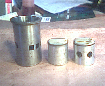

The Fox changed over the yrears and so did the K&B/Veco. Try and put the ringed piston in the ABC cylinder. The needle is now in the back and it used to be in the front. there have been several different Carbs and the parts from a K&B Carb will not work in the Veco carb. Just like the Fox it evolved but it is still the K&B61 and the Fox is still the 35 Stunt

loughbd:
Wrong on the date? I'll allow that, but you are wrong about the ABC engine. The RINGED K&B 61 is still in production, and all the mechanical parts still interchange. Carb? The carbs were obviously different in the two pictures I posted.
The Veco 61 and the current K&B 6550 engines are still the same.
There is one internal difference that has no effect on parts interchange. The earliest Vecos had a plain skirted piston, but before K&B took over the design auxilliary bypass ports were cut in the piston skirt, with matching ports in the cylinder sleeve. Adn one more - the earliest Vecos had a Dykes ring. See picture.
But the sleeves and pistons still fit one to the other.
Bill.
Bill.

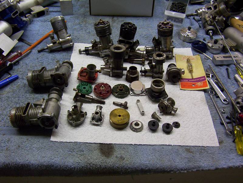

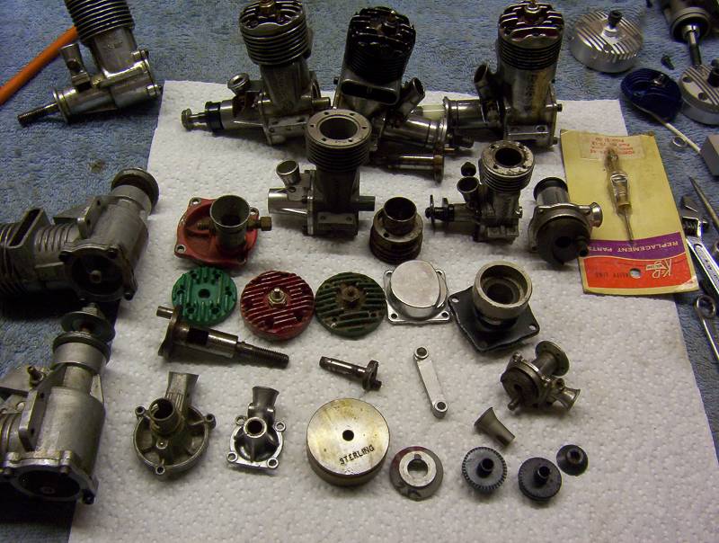

#73
Joined: Apr 2003
Posts: 189
From: Hope Mills NC
Bill,
I have several McCoy engines ranging from early 50's to late 60's. I'm going thru them and cleaning them up, getting them loose and lots of lube. Some have red or blue heads. I want to give the heads a fresh coat of paint. Do you know of a matching paint in spray cans? The red, I think I could match, but the blue is about gone and not enough left to get a match.
Also, do you know of a source for parts for .19, .29, & .35. All of these are the ones with cast fins and heads prior to the Testor days
Any info would be appreciated.
Richard
Richard
#74
Posts: 20,205
Received 20 Likes
15 Posts
Richard:
Sorry, I know of no parts source, nor do I have a match for your paint.
Some of the Testor's engines, esp the "Red Head Racing Engines" had anodized red heads, but the front and rear covers were still painted.
Bill.
Bill.
