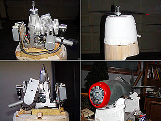

The only engine I know of that might be a good match is the RCS 140 from www.rcshowcase.com. That's what I'm putting in mine. I wish it was completed already, so I could tell you exactly how it does. I've attached a small picture below, and more are available on my P47 page:

A 35-40cc gas engine would NOT be a good choice for the .60-1.20 sized P-47. BalsaDuster must be thinking about the giant-scale P-47, not the one that runs fine on a 0.75ci glow engine.
The MVVS 1.6 is an interesting option, cheaper too. However, with its stock muffler and carb, it is heavier than the RCS and will NOT out-perform it. 8,200rpm's on a 16x8APC, tuned down to 8,000 to avoid overheating? The RCS will do >8,800rpm straight out of the box.
With a much better muffler or a tuned-pipe setup, the MVVS kicks the RCS's rear (even more so with a modified carb that voids your warranty). As it should... being a bigger engine and all. A great thing on a 1/4-scale aerobatic ship... but on a 1/8th-scale warbird? The RCS is already way more power than the P-47 needs. Also, if you live in the USA and buy your MVVS from overseas, guess where you have to send it for repairs or to get parts? Morris Hobbies, the USA importer, doesn't list the 1.6... I wonder why? I sure would like to play with one (I love my MVVS GRRT)!

These scale birds are already heavily wing loaded. More weight is not gonna help. These are .60-.90 size planes and 1.20s are not bad but already kinda pushing it already. The RCS 140 seems a good fit and is very lightweight. The MVVS 1.60 is a bit heavier and might work. Any of the Zenoah would be way too heavy. G23 weighs over 50 Oz. while most 1.20 are in the low 30 Oz. range. One lbs is a lot of different in a plane this size and type.

The RCS 1.40 is a superb motor the wieght to power ratio is equal to 50%-75% of the 1.20's currently on the market. Second Plus for Gas is that you only need an 8 Oz Tank in your Aircraft for 15 Minutes of flight. Thus you have just equaled the Wieght of a 1.20 and a 20+ Oz tank of fuel.
The RCS turns a 16 X 8 APC @ 9100 RPM Static Thrust is about 16 Lbs.
Engine Weight with Muffler is 2 Lbs 5.Oz.
Engine RPM with APC 16x8 prop
RCS 1.4, one gallon through it, small carb 8,500 @ 66F, (8700 @84F)
RCS 1.4, 1+ gal, large carb, and TT 1.20 muffler 9,100 @ 70F
YS1.20NC with 10% nitro, well broken in 8,500
TT1.20 Pro, 5% nitro, one gallon through it 9,000
