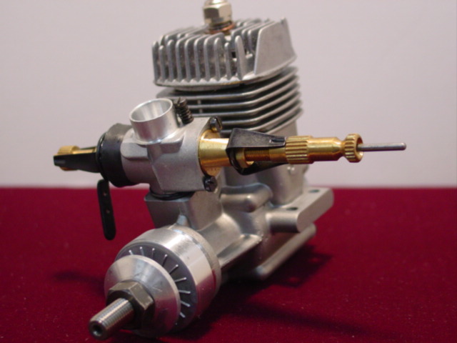

Good news, I set the small and large needles as said, and also repaired the one bent one, and she fired up. Ran into two more problems though. First it seems like the fuel wants to go backwards down the fuel line. This might be because I only have about 1/2oz of fuel left. I need to make a run down to the LHS and buy some sort of hand fuel pump, because I was using my friends fuel and pump.
Second problem, it seemed like the high speed needle was backing off when the motor was running. The other needle valve can't do this do to some sort of locking clips. Is my motor missing something? Maybe some teflon tape on the threads?
Philip

Here is a picture os mine and you can see the locking clip that prevents the HS needle from turning...

A picture is worth a thousand words, thanks.
My motor also looks different, in that my motor has a round head. And the needle valve looks different also, mine does not have the thumb screw, but a "T" at the end. Is there a way I can make this work, or do I need to find a replacement?
Philip

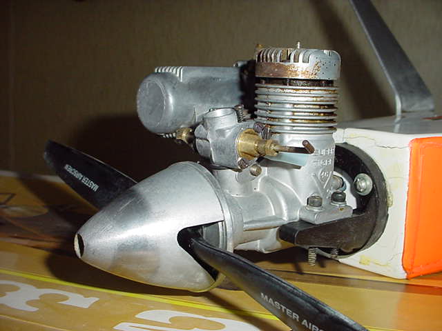

I think this oldie is the one you have. After you get
the needle set....snug-down that "nut-collar" to secure
the needle, so it won't turn.
Dave.

that's it, so how ancient is this motor? Locking down on the nut fixed the problem, thanks

That motor is 25 years old and still runs like a
top. It's been Idle for awhile as you can see....I
gotta clean it up and run the poor thing.
The thing is....if your motor has good compression
after you ran it for awhile....it'll probably give alot
more service. Tighten up all the screws, clean it up
real good, and enjoy the ol' motor.

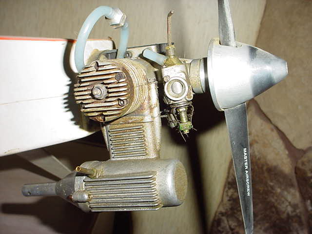

.....if your muffler looks like this....it's about
a 1975-76 Vintage. Darn good running motor,
but cobby looking compaired to the O.S., and
the K&B's.....
Dave.

That is the way my muffler looks, I have a clasic here. Maybe I should put her in a glass box and frame it Nah, if she runs I'm going to fly her, unless you think she may be worth some money?

They were good engines...ran perfect...they were about
the first carbs that had the double needle set up.
O.S. had just come out with the 7B carb in the FSR's
but everyone else had single needle stuff with airbleeds
and rotating disks and stuff, like the K&B's and the
Perry carb ones.
The S.T.'s were big in control line contest stuff, at the
time....but weren't big sellers in R/C mainly because
they were UGLY !!! I bought this engine, and
a .61 S.T. at the original Hobby Shack in Fountain
Valley, Cal. for $34.95 each. I ran the .61 for almost 25
years in a Rebel Biplane, and it still runs perfect.
My friend has it now, and still flies it ! I'll clean the
little one after while....gotta get some yard work done
today....and I'll post another pic.
Dave.
