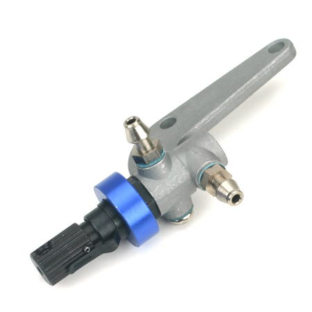

My mentor moved!! I need to re-adjust my throttle linkage. I know there is a way to swivel the entire needle valve assembly that is the nearest the front. I am not sure which of the set screws to adjust. There are two "allen" head screws, one on the blue ring and the other on the silver. Which one? I need to adjust because the clevis and push rod are rubbing on the motor clamp screw.

The silver one

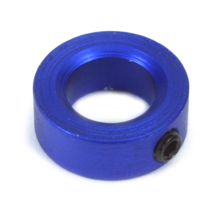

The blue ring (if I remember) is actually a throttle adjustment limiter that prevents you from over-tuning the engine. On mine, it actually prevented me from achieving the setting I needed. Loosen the allen bolt, slip it off and forget about it.

Actually DO NOT "forget about it"...
If you do this the needle valve will turn with engine vibration as the engine warms up.
Instead remove the limiter and pull out the metal pin, then re-install it.
Before you do re-install it, also pull out the clip and bend down the clip arm a bit more to apply more pressure.
The limiter holds the clip in place so that is another reason to keep the blue aluminum limiter w/o the pin.

There are two different limiters.
The one that the gentleman asked about is in the area of the low speed needle.
The one that you cannot completely remove is the remote high speed needle.

Re: Needle.
Yes the high speed is what I was talking about.
I've never have needed to remove the low speed needle, as all you have to do is loosen the cap/grub screw and then adjust the engine.
Since the low speed needle tends to "walk" was well, it is advisable to adjust the engine and leave the collar in place along with the pin.
Better still tighten the blue collar/limiter against the engine as you tighten the grub screw to provide more friction to prevent the low speed needle from walking.
