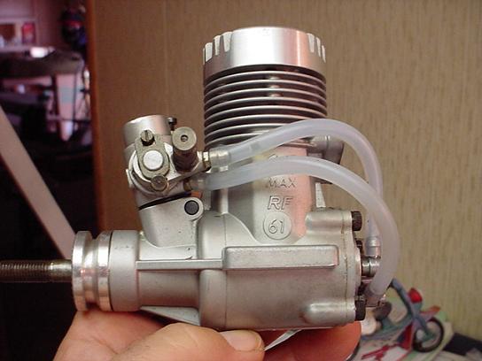

Just got this motor from a guy in Austrailia. As usual,
no box...no goodies, and no instructions. Never had one
of these O.S. pumped pattern motors, and need help
with the fuel hook-ups....

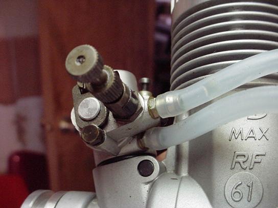

First....what's up with 2 fuel lines going to the carb ?

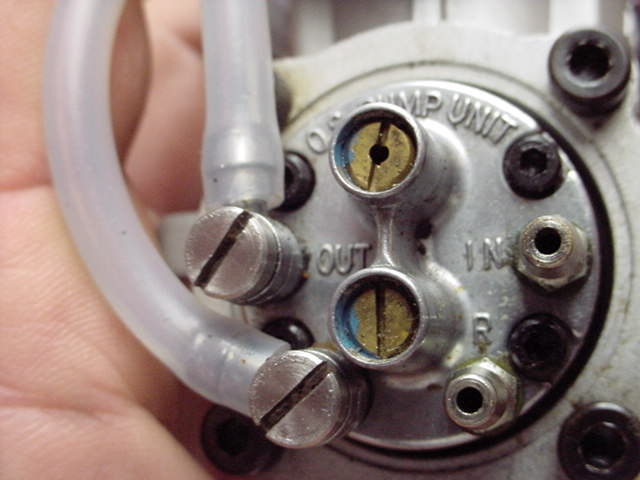

Here's the pump....4 lines.
In....OK
Out....OK
"S"....line goes to the carb below the needle valve.
"R" ...line I guess would go back to the tank.
Do I still need an open vent line, or is the tank
sealed....or do I still run pressure from the pipe.
I'm thinking I won't need the pipe pressure anymore,
but will the fuel stop flowing if the tank is not vented ?

The two adjusting screws appear to be factory set,
and marked with blue paint. I wonder what is what,
if they need to be reset ? I promise I won't monkey
with them.
Does any one have some instructions for these engines
they could copy ?

It appears that the lower carb fuel line is a return line
for excessive fuel to the carb. It appears that the upper
adj. screw is for the fuel pressure. I don't know why it
has a hole in it....it looks like a M/C main-jet. The lower
"return line" marked "S" must tie into the "R" line as a
return line to the tank, and I'll guess that the lower adj.
screw regulates the amount of fuel going back to the
tank.

OK Dave, here's the skinny: You have the two silicone lines hooked up ok. One is to return to the pump excess fuel at times. The lower right hand nipple (in your picture) goes back to the fuel tank. The upper right nipple connects to your tank clunk line. You run this set up with no muffler pressure--just an open vent line. Set the needle valve like any other--just a shade on the rich side of wide open. I ran several of these engines in pattern. Still have one. They are strong and reliable. The Hanno is about the same thing, but the pump is less complicated.

The nipples on the carburetor are:
1--nearest the needle valve: from the "out" line of the pump. this is the fuel feed to the carb.
2--inboard and lower from the needle. This connects to the "S" nipple of the pump. This carries venturi vacuum to the regulator in the pump.
The "R" nipple on the pump returns excess fuel from the pump to the tank at low throttle settings. You want to have this line dump at the forward bottom of the tank.
The "IN" line--this is the fuel line from the tank to the engine. It attaches to the clunk line in the tank.
Proper setting of O.S. pumped engines involves setting the high-speed needle as lean as possible without detonation or RPM drop. LEAVE IT THERE! If you have good fuel, the lubrication will protect the engine. You may be able to richen slightly, depending upon how the enigne runs in the air.
If the idle mixture's too rich, and it's as rich as the adjustment screw will go, then the high-speed needle's too rich.
The upper screw on the pump adjusts the pump pressure. It is factory-set so that the high-speed needle's at peak RPM when it's one turn out.
The lower screw adjusts when the return line opens to return excess fuel to the tank.
No fuel is returned to the tank from the carburetor.
Hope this all helps.
