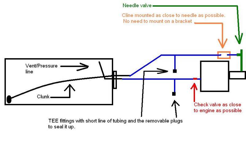

Ok, after reading all the great posts on Moki's I picked one up for my CMP Extra 72". I am running some 5% fai fuel in it and ran about four 24oz tanks on the stand before mounting. I tapped the back and mounted a perry vp-30 and tuned it up. Weighing in at about 13.5lbs and running a Bambula 18x8 wood prop I expected this thing to skyrocket. I am still running a bit rich on the highend but probably only about 5 clicks or to drop about 400 from peak. Well even with the pump there appears to be a change in the ratio as mid flight I am definately blowing less smoke and what is noticably rich at the start is probably right on at mid flight. Not sure why that is happening. I do have a pressure bypass system with a T fitting between the pump and the carb with the bypass going back to the tank. I put a zip tie around the bypass to shrink the whole some but fuel can definately flow back through it. The tank is on the cg which is about 8 inches back from its original location. Anyway to make a long story short its not as impressive as I would have thought. I had a GP Giles of the same size and weight with at ST 2300 1.4ci running a 17x6 APC that would pull the plane out of sight. This Moki setup can just barely pull out of a hover. My first impression is that the Bambula 18x8 (although being a wide blade) is not the right prop (at least here in Illinois). I have always been dissapointed when trying wood props and always had a noticable difference in power when going with a APC. I am thinking about either my 17x8 APC or the 18X6 Wide APC. I am using a O.S. F plug on the engine. I have a feeling either my pump setup isn't perfect, wrong prop, or something tired about this engine. I did buy as "New" on ebay and indeed the engine had no castor stains on it and the sleeve looked like it had never been run but when I received it the engine was locked. I had to pull it apart to find the crank had rust on it and I had to oven heat it to free up the bearings and then oil it all down. Sleeve all looked new though so I don't know if its possible that it was just old but new or if someone bench ran it, didn't oil it up, and put it away. Brand new compression though. Anyway if anyone has some advice or tricks for these I would love to hear it.

I had a feeling the perry was going to get a response. I appreciate it and will look into the cline. Looking at the diagram:
http://www.billsroom.com/pcfs/produc...g/Pcfs1t1e.gif
In this setup are the overflow and fill lines supposed to be plugged during flight? And if so what keeps the crankcase pressure from exceeding what the tank can take? Being that it is pressurized do you have to worry about the fuel tubing pushing itself off the nipples on the tank? Why do they say its a unique one way check valve? I assume the regulator is the PCFS in the diagram. It seems like this is a relatively plug and play system. I don't see any knobs to turn or adjust. Is that the case?
Mounting the Cline is a lot easier than it looks. Very simple.
You already have the backplate of the engine tapped. You need to run a fuel line from the backplate up to the vent line in your tank. But, before you hook it up--Cline gives you a 1-way check valve to use. You take that check valve and stuff it up in the line about 3/4" and then you stick the line on the nipple you have mounted in the backplate. You want the check valve mounted as close to the engine as humanly possible. 1" or less.
Now that will take the crankcase pulses and presasurize the tank. The check valve will prevent the pressure from coming back out. So, now you got a pressurized tank. I use DuBro tanks and have never had one split out. If you want a bulletproof tank--get a Kavan. I've had a Sullivan slant tank blow it's guts all over the inside of a plane just from muffler pressure. I don't use those anymore.
Okay---pressurized tank. Mount the Cline regulator on about 1" of fuel tubing and plug it into the inlet nipple on the carb. I've done more than a few Clines (about a dozen) and I think it works better if you DON'T use a remote needle valve. Leave the needle on the carb and plug the Cline right into the fuel inlet nipple on the carb. The Cline should be 1" or less from your needle valve.
Now the other side of the Cline gets plumbed to the clunk on the tank.
You will installt a T fitting in both the pressure line and the clunk line. Run a short piece of tubing on each of them and mount them so you can get access to them without removing the cowl.
How it works:
The engine pressurizes the tank. That forces fuel up to the Cline and provides constant and positive fuel flow to the Cline at all times. The Cline has a diaphram inside and a couple valves. It senses the vacuum of the carb every time the crankshaft rotates and opens the hole under the carb. It lets in the fuel as the engine demands it. No more--no less.
You hook it up and pressure test the system. Use wire ties or clamps on everything to keep from blowing the lines off.
Start the engine and let it idle for a few seconds to build tank pressure. Rev it slowly to build all the tank pressure it will ever have. You need to do all your tuning with the tank fully pressureized. It won't get fully pressurized untill you rev it up to full power and hold it for a couple seconds.
NOW you can tune it. Run it up to full throttle and adjust it for max RPM. Back it off about 3 or 4 clicks.
Now adjust the low end. Just set your low end for perfection. It should idle for a whole tank without loading up. The Cline will not allow it to flood the engine because if you adjusted it right--it only lets the engine suck in the fuel it needs.
I've actually mounted 2-stroke glow engines upside down with the tank on the CG. Install a Cline, adjust your carb and it will run flawlessly without any on-board glow or fancy hot plugs. They just RUN.
To fuel it:
Take both plugs out of the TEE lines. Plug your pump into the clunk line and fuel it untill the fuel comes out the pressure line. Same as a regular glow setup. Fill through the clunk--it's full when it comes out the tank pressure line.
Plug both lines. Go fly.
When your done flying:
Pull the plug from the pressure line and let all the pressure blow off. You'll know you pulled off the clunk line if it squirts out a bunch of glow fuel. [sm=tongue_smile.gif]
Worth every penny IMO.

My Feedback: (14)
ORIGINAL: spyder0069
***If you are running muffler pressure, disconnect it. Muffler pressure disables the regulator function in a VP-30 Perry Pump. This would explain the unregulated behavior your engine is displaying.
***You don't need all of that return line crap for a large two-stroke. If the Perry Pump is good, its output is adjustable.
***If the engine truly is new, it is going to take several gallons of fuel through the engine before it attains full power and good throttling manners. Worrying about minutia on a new ringed engine is pointless. Mount it up on the test stand and start running fuel through the engine before worrying about anything.
***Are we talking about a 1.35, a 1.80 or a 2.10 here? I'm assuming a 1.80 - just a guess.
Mokis are made from good metal. Good metal takes a while to wear in.
Personally, I prefer the Cline or Iron Bay regulator set up. Adjustment free with great results. Truthfully, I don't think the Perry Pump is the problem from your description. The engine isn't broken-in yet, that's all.

Thanks for all the great advise. The engine will idle all day long with no problems and so far the only deadstick I have had was when the throttle arm nut wiggled loose and the barrel stuck shut. :^) Hey at least it was a regular deadstick instead of a full power until the fuel runs out and then deadstick! Ha ha. I think the engine just isn't turning up. I'll start with a few props and get a cline once my airplane fund recovers. I know on my ST2300 it ran like crap when propped with a 18x6 wide at around 7300 rpm and then went to a 17x6 regular and it was screaming at 9K. Tons more power! I see alot of posts about many of the big two strokes being "luggers" and so far I am not convinced. Two stroke gas engine maybe. But so far I have found two stroke glows are just like the smaller engines they like the rpm. Seems like 7k anything is too slow. 8k or higher seems to be the sweet spot. I'll shoot for that.
