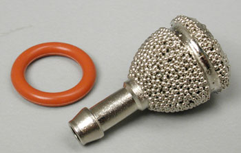

Old 10-09-2006 | 07:38 PM
w8ye's Avatar
My Feedback: (16)
Posts: 37,576
Received 11 Likes on 10 Posts
From: Shelby, OH
Default RE: saito 100 help
OS sells a bubble removing clunk.. They work great.
