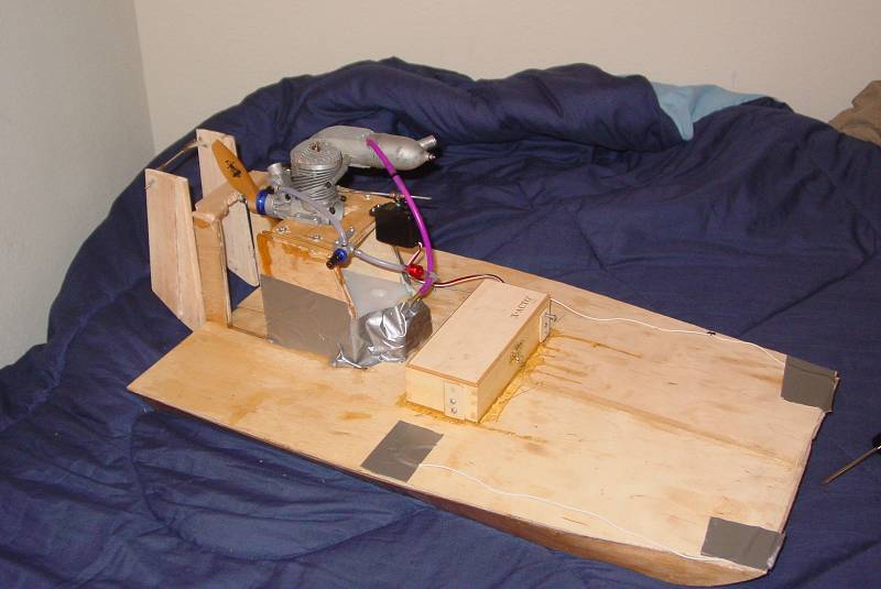

I have a evolution .46nt engine. The problem i am haveing is that the engine starts backwards. I know that I am starting the engine the right way. In the past if the engine started backwards I would have to turn it like I was starting it backwards and it would start the correct way. I had the engine put in my closet for about two months to four months. But now the engine starts backwards no matter which way i turn the prop.I an spiningg a 9X6 reverse pitch prop which is smaller that the one that is recominded for the engine
P.S. The engine is on a 24" long airboat (swampbugy if that is what you know it as) but it is a airplane engine. I could not find a pull start conversion for it or an electric start. I also can not use a 12v eletric starter as you can see in the pics below

Try to less priming.Overpriming causes such reverse starting.But in your case insufficient flywheel effect can be the cause.Then I think a colder plug helps too.

You are over-priming it for sure, like Turk1 wrote.
After priming the engine properly, I have seen some Evos that responded great to back-flipping.
You don't turn the prop backward; just 'bump' it against the compression.
It will take you a while to get the feel and it is best if the prop is mounted, so the blades are horizontal, as you start feeling the resistance of compression.
This is good for flipping regularly and also for back-flipping.
When the engine starts with a pusher prop and you are facing the prop, it should blow air in your face...
Cooling is impaired, as long as the model is standing still and will only be sufficient in flight.

Like others said, too much fuel in the engine when starting will do that. Pull or pinch off the fuel line next time, then let it run off the fuel in the crankcase. Often, just before the engine dies, it will kick off in the correct direction for a couple of seconds and sound much happier when it does. You can often release the fuel line just at that point and off she goes, a technique I use when I've pulled too much fuel in during choking, but not I guess entirely recommended by the safety committee. A better tactic is to go easy on the priming/choking. You can simply pull off the line (and the muffler pressure line too unless you want to bath the model in fuel, or plug the fuel line) and hit the engine with the starter to let it burn off the excess, don't worry which way it is running at that point, just let it burn up fuel.
Once/if you get the engine idling, try pinching the fuel line to see if and how much the rpm increases before it starves.. you can release it before it dies. A small increase is okay, but if it speeds up notably then your idle mixture is too rich fer shure. Lean it a bit at a time . A clue is the transition from idle to high throttle - with plug heat off. Too rich and the engine will stumble when you advance the throttle. The idle needs to be towards the lean side, so that the rpm only jumps a little with the pinch test. A too rich idle does no good at all. The engine is not producing a lot of heat at idle but remember that by leaning out I don't mean going too far, but just to the point where it runs and transitions cleanly. If the engine dies quickly when you pinch the line then you have gone too far [okay, I see the Evo 46 has an idle mixture limit too - if so you're not going to go too far]. Ideally (ideally to me.. others may differ) if you pinch the line, the rpm should increase just a wee bit, and after about two seconds or so the engine should start starving for fuel. You should do all this after setting the top end correctly, then check the top end once more afterwards.

A 9-6 is not going to hurt your .46, but it is on the small side for your application and a prop with more disc area and perhaps finer pitch is going to perform better. For an airboat you have a lot of load and the top speed is not high enough to warrant a prop running at a pitch speed of 100 mph+. A 10-6 pusher is as mentioned a better choice. If you could find an 11-5 pusher even better, but I don't think there is one. Master Airscrew has a 10-6 pusher, APC makes 10-6 and 11-6; In truth, since a smaller prop runs cooler the 10-6 may be the better choice from that standpoint, but for the airboat if it fits, the 11-6 may work really well too. Perhaps try that after getting some running time on the 10-6.
In terms of running up your engine static, to tune it, test throttle transition etc., personally I would recommend fitting it with the tractor (normal) prop of the same size as your pusher - that way you get all the time in the world to set it up with no fear of overheating due to lack of forward speed, and you can spend a whole tank full of fuel tinkering if you choose to or need to.

You might consider lowering your cross-brace for the rudders to about half way down, then get a starter with en extension on the shaft. These MAY be available for ducted fans (I'm not a starter guy). I'd try to borrow one, if possible, to see how it works.

the box is used so that the recever and battery dont get wet whiile it is in the water and just in case i flip it over in the water i dont want anything falling out and and i used the x-acto tool box b/c it was already builtand everything fit in it nicely

I answered in your other thread. Now I see what you're trying (wrong) to do. I had the 60 size Dumas Swampbuggy and a scratch built 40 size. I made it easier on myself by having the engines facing forward. Guess that's why the plan designers did it that way also. As one poster mentioned, the engine will stay much cooler and you can then use the electric starter. Turn the engine 180 and your life will be in better sync with the universe.
Forgot to mention, you need to put fuel tubing over the rudder rod detent screws. Metal to metal rubbing will cause RF interference.
I'm surprised the engine will run at all -- The tank outlet should not be more than 1/2" below the centerline of the carb unless you have a pumper on the back of crank case.

I have built maybe 3-4 airboats like this over the years, in .15-.25 size, and they have always been great fun. However I ran all of them in tractor mode with the tank in the engine pod. CG has never troubled me, they all bank into the turns. I make the pylon flush with the rear of the engine/tank pod, and use that as the vertical fin, with a single large rudder hinged off that and no water rudder. They all had great rudder authority, and could be driven on water, grass or snow. Good cheap fun. Most were made from foam flutterboards covered in either polyurethane or epoxy finish, and a square of 1/8" plywood bonded to the deck where the pylon fit through for support. I inset the pylon into the foam with liberal amounts of epoxy (though now that it is availableI would much sooner use Gorilla Glue or Probond), and glassed or V-stocked the corners to the plywood base. Never ripped a pylon out, though I never drove one into anything at full speed either. Hold the engine pod for starting and launching though.
