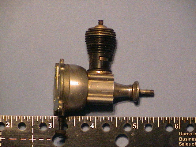

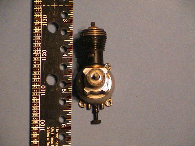

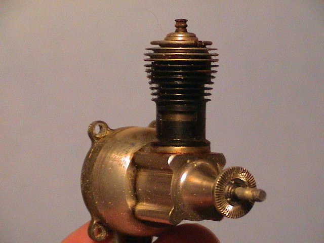

I have no idea what this engine is. Any information or even research tips would be greatly appreciated. This engine will not turn, so is it possible to return this little engine to running condition?

Cox Babe Bee .049 from the late 50's or early 60's
Try soaking it with some very thin solvent around the exhaust ports for a while. Do not use pliers on it.

Correct me if I'm wrong but wasn't the baby bee a single port cylinder and the super bee a dual port? I had a golden bee with the bigger tank but you just had to have the dual port guy for those combat wings we had so much fun with.

Yes, the original Babe Bee was a single intake port.

BTW, someone has reversed the tank. The needle valve needs to be facing up. They must have run it cylinder-down.
The Babe Bee and the Golden Bee were both single port. Don't have a Super Bee.
