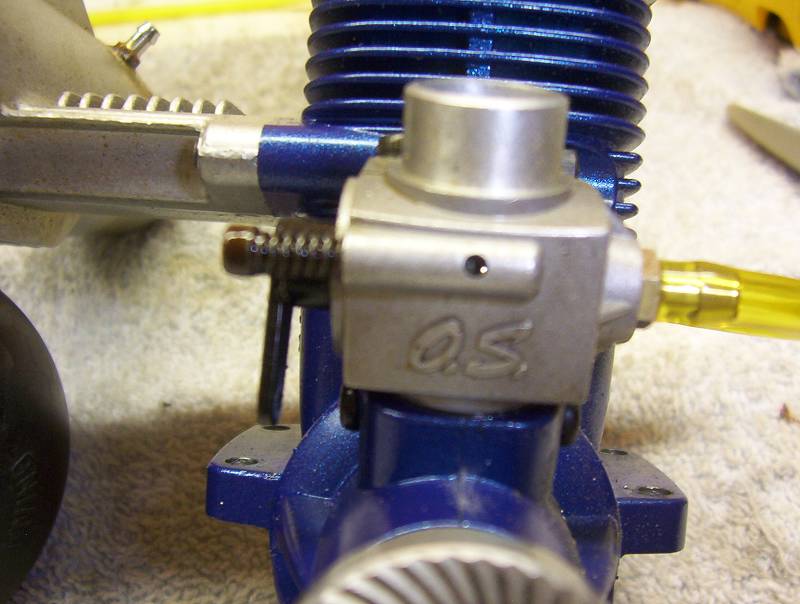

Old 12-16-2006 | 10:12 AM
  #34
Hobbsy's Avatar
My Feedback: (102)
Posts: 20,370
Received 30 Likes on 28 Posts
From: Colonial Beach, VA
Default RE: OS .46 LA (Bad Engine?)
Right here is where my LA's all three idle and transition the best.
