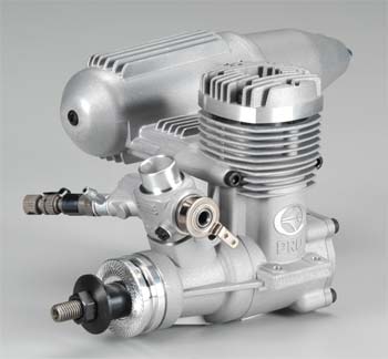

Who the heck takes the photos used on the Tower site? Obviously someone in a professional photography studio.
