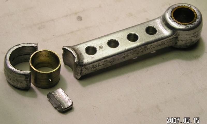

Howdy Saito lovers, here is another update from Sweden. After fitting the new main bearing in the Saito.65 (post#26 above) it was assembled and tested. It was clear that the engine by now had become a bit "loose" in the conrod big end but it still ran nicely without excessive noise. My friend who owns the engine mounted it in his UltraSport and up it went the other day with myself at the sticks. All went well for a while but then suddenly....SKRUNKK...!...the engine came to a sudden stop and I(we) thought:...OK, that´s it now we have at last reached the limit for "swiss-cheesing" and the owner muttered something unprintable with a clear address to me....
Taking it apart revealed that - sure thing - it was the conrod that broke as we both expected but not exactly where we(he) thought....[
]....!...which restored some of my battered ego.
Flyer95, do you think we could cooperate to produce a new conrod to thÃ*s engine being about 1mm longer than stock...??...will call you later about this since that would take CR up from current 11.1/1.........sack time here now.....Cheers/Harald
....!Taking it apart revealed that - sure thing - it was the conrod that broke as we both expected but not exactly where we(he) thought....[
]....!...which restored some of my battered ego.Flyer95, do you think we could cooperate to produce a new conrod to thÃ*s engine being about 1mm longer than stock...??...will call you later about this since that would take CR up from current 11.1/1.........sack time here now.....Cheers/Harald

How high do you intend to take the compression?
Funny that the places you lightened the part didn't fail, but rather a part you had not modified. I imagine that most likely the failure was due to the "looseness" of the conrod, and thus a stress failure on that part.

RVM, yes it was good to see that it broke at the big end and not along one of the "cheese holes"...!
I still intend to reach CR 13.5 as proposed by downunder et al. but have so far only obtained CR=12.5 on my most modified engine. This .56 has the "skeleton" piston and other "guts" as shown in post #22 above and has been milled -1.3mm from the case. I have flown it twice in my Sig Cougar just recently and this engine runs better than ever before so I intend to continue in incremental steps towards 13.5 as time permits.
I´m still not sure if CR 13.5 is possible in a Saito.56 without parts hitting each other....downunder, can you chip in here from your experience/sources..??
As an example we modified an old Saito.40 by arbitrarily milling -1.0mm and that turned out to be exactly what was possible with its piston just about hitting the glow plug. CR on that .40 increased from 7.1 to 9.3 in the process but we have not yet had the time to run it.
....anyway CR research continues....
.....RVM, how are you doing with your .82...??....Cheers/Harald
