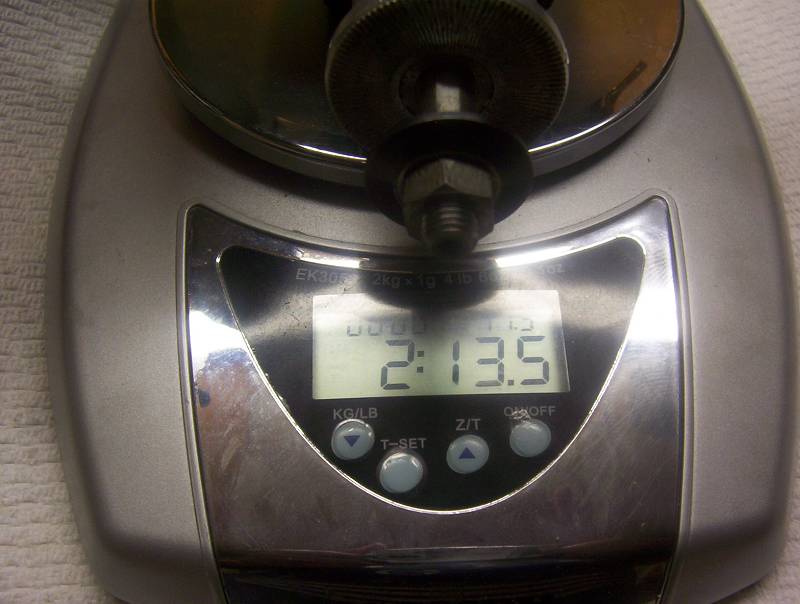

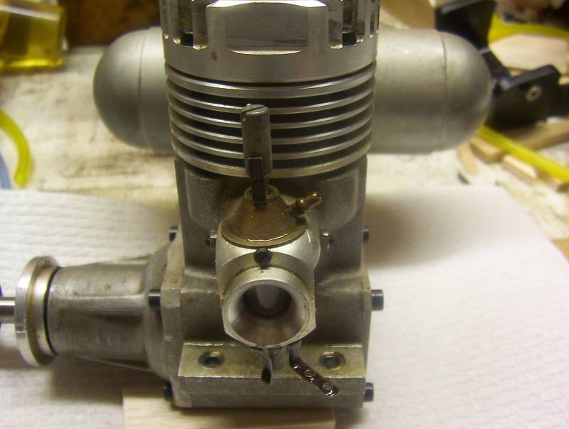

Here is my Suevia 1.50, it is Serial# 492 out of approximately 500, it barely makes 1.20 sized power and at the weight you see it is no light weight. My take is that it would be a very reliable engine never offering to stumble or quit. I ran it on 5% Fox fuel with 20% castor. It has a roller bearing rear main and is very smooth running, that huge muffler is fairly quiet.

I remember seeing one of these for sale in the RCU swap shop recently. I don't think the seller even knew what it was. He just called it a "big german engine". I could see that it was a piston port design, and figured it was no barn burner.

Many thanks for your input and the download which I will get translated. The pictures are great, is the 150 actually the 25cc? is that a scale showing 2+lbs ? I get the feeling the power is not what its supposed to be from your feedback so I am slightly concerned if it will generate enough power for my model. I will attempt to weigh the model and send you the info if you dont mind when finished. Could you give me a guesstimate on what this motor can handle on a high wing J Cub style model as weight. Thanks again.

Double F, if I get a chance today I'll run it with a couple of different 16x6s and 16x8s to get some useable numbers. The weight should not be a problem on the short nosed Cub. And yes, 20cc is a 1.20 give or take a little, the 25 would be about 1.50.
25x.061=1.525 cu. in.
