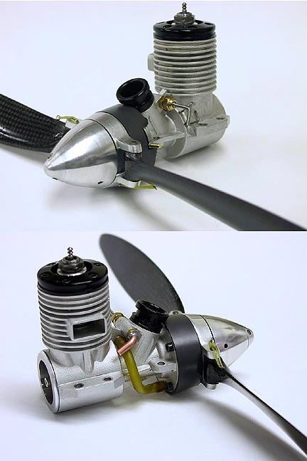

Here is a picture of the geared Nelson 15

The Neslon setup runs in the $800-$900 range. I would guess that the airplane to go behind it would be even more. They gain over 500 feet in 5 seconds and are stuffed with auto-controls to change from a vertical drag racer to glider.

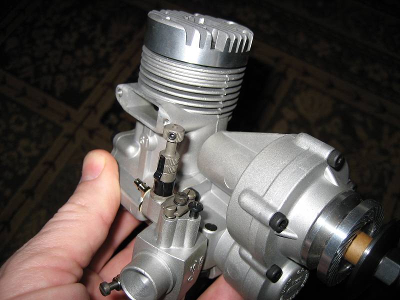

buzzingb... Gear reductions are not restricted to small, high revving engines. This is an OS .61. The gear reduction on this engine was before 4-strokes became common but noise issues were getting to be very restrictive. Folks figured out that the high prop tip speed was producing more noise than the engine and turning the prop slower helped. As B.L.E pointed out, rules in the pattern world at the time also partially drove the development of these engines.

Any info on what size prop that geared .61 would turn?
I'm still looking for that. I went through the documentation last night and it didn't suggest any props. I'll let you know when I find it.

I've seen photos of that geared OS 61 before but I just noticed something interesting in the shot of it from the exhaust side. The front housing has been rotated 90 degrees to put the carb over on the side. This alters the crank timing so the engine runs in reverse direction. The gears then have the output shaft running in the normal direction.
