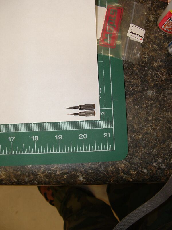

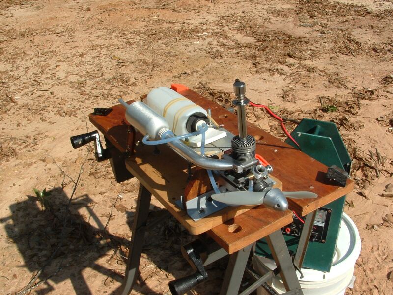

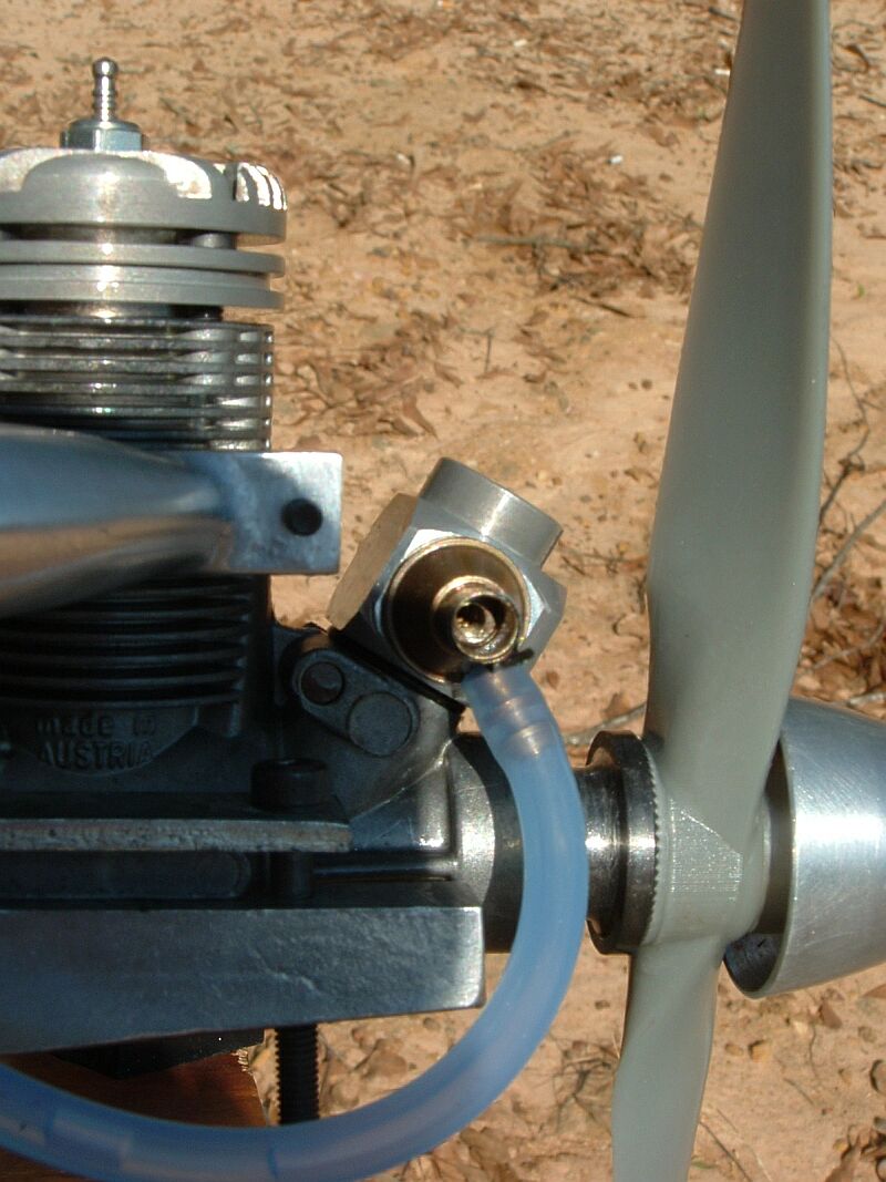

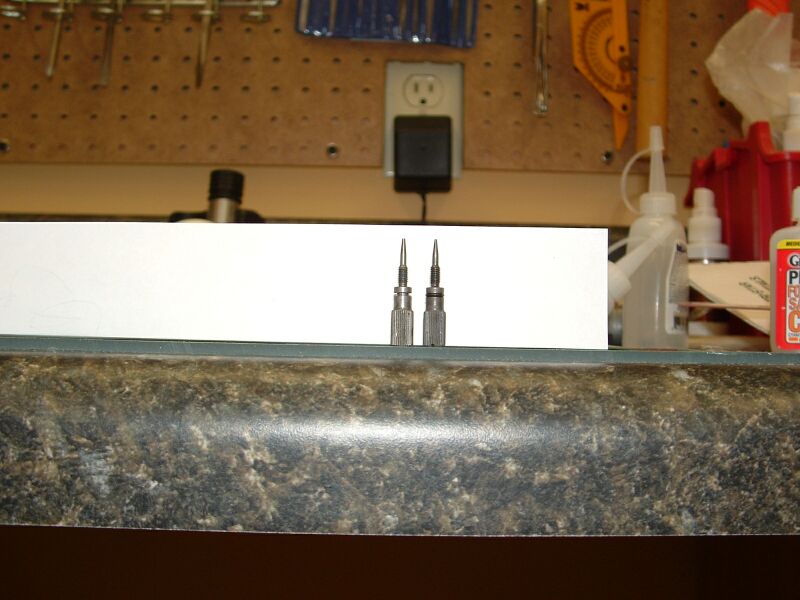

Pics of the stand. needles and spraybar assembly
Pete

Well besides carb is on bass-ak-words. Pipes tend to burn out plugs faster with your HS needle in too far tells me your LS needle is still a little rich. With the pipe and 10% on a webra a miricle plug is too hot. Try a Fox RCLONG or Standard LONG or stay with OS 8.

It's hard to see but it looks like your HS needle spring clip is there. If it isn't some needles self adjust while running. And if your prop is such a load and you barely get on pipe staticly on the ground and in the air you really unload and get on pipe more your going to burn more plugs without being richer.
The mousse can pipe will not burn out plugs. Webra HS and LS needles interact a lot, and my opinion is your low end is very rich. Try the McCoy MC9 plug. It's a tough plug that I've used in my Webra and OS engines for years.
Dr.1
PS Turn the carb around the right way, too.

The carb was turned around because on an Outlaw it's side mounted and this puts the needle on the proper side.
Played with it some more with the same fuel it's good. Needle clip is there. Leaned better this time got 15750 rpms with the 8x7 prop. Pinched the line and it it died backed off 3 clicks and pinch test was good. Then set the low end Waaaay to rich. Didn't get a good idle and decent transition until for well over 1 1/3 turn in. Nothing really changed from earlier can't explain the improvement.
It's good enough to mount and test fly. Even when she ran her best it would take a second or two to unload on the pipe. The sweet spot must be really narrow between rich and lean with this setup. I continue to use the 8x7 because of the good pull you get when tossing the Outlaw for launch.
